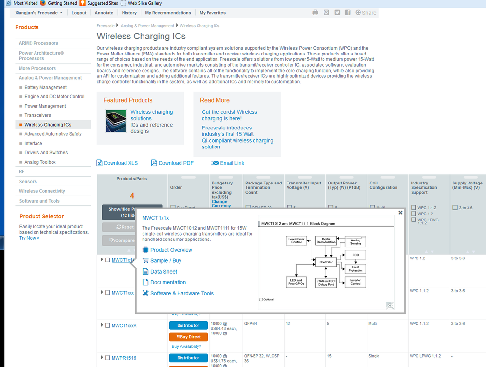

xiangjun_rong
Hi,Hadeel,
click the following link, you will find the menu as screenshot, then click "Software & Hardware Tools", you will enter another menu, which will enable you order the wireless charger transmitter/receiver board" on-line.

hadeel_irshaid
Hi XiangJun Rong,
thank you for your help...
but I have a question.. can I order the solution online? if so please tell me how to do that.
