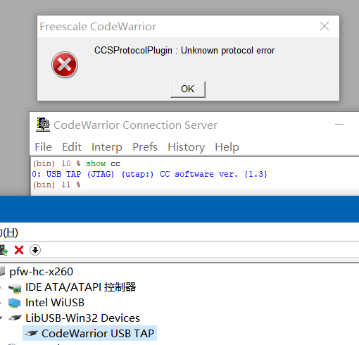

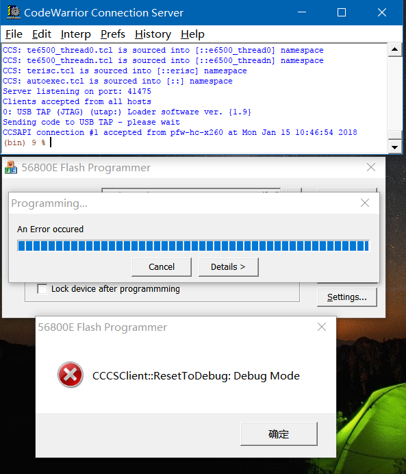

During the troubleshooting, I got with the 56F8567 and the USBTAP,
When I look carefully with a scope the JTAG/Once chronology programming a DSC with the USB TAP, the JTAG keep the RESET signal during fist serial sending the TCK/TDI signal. During this short period of time the micro is in debug to initiate the JTAG communication and the reset signal is released. I had the same message due to the hardware. In your case, you should keep your RESET\  signal tied to VDD and only drived by your USB tap to let your UTAP initiate your JTAG.
So, You should check if your reset signal is fixed by your hardware somewhere else.

I had a lot of troubles with the USB TAP device too, with the metal model and with the black plastic model too.
Not only that it is not stable, it has problem in stopping at the correct address with breakpoints (works good only in a simple short job).
This issue has been handled by Paulina from the support team 2-3 years ago, but all was in vain. She told me that the development team admitted that there are bugs, but they did not issue a new firmware.
I recommend you to use the PE Multilink Universal for DSC. It works perfect.

I checked connection cable, also to mention the board is always OK with my PC and colleagues, this error happens occasionally.
