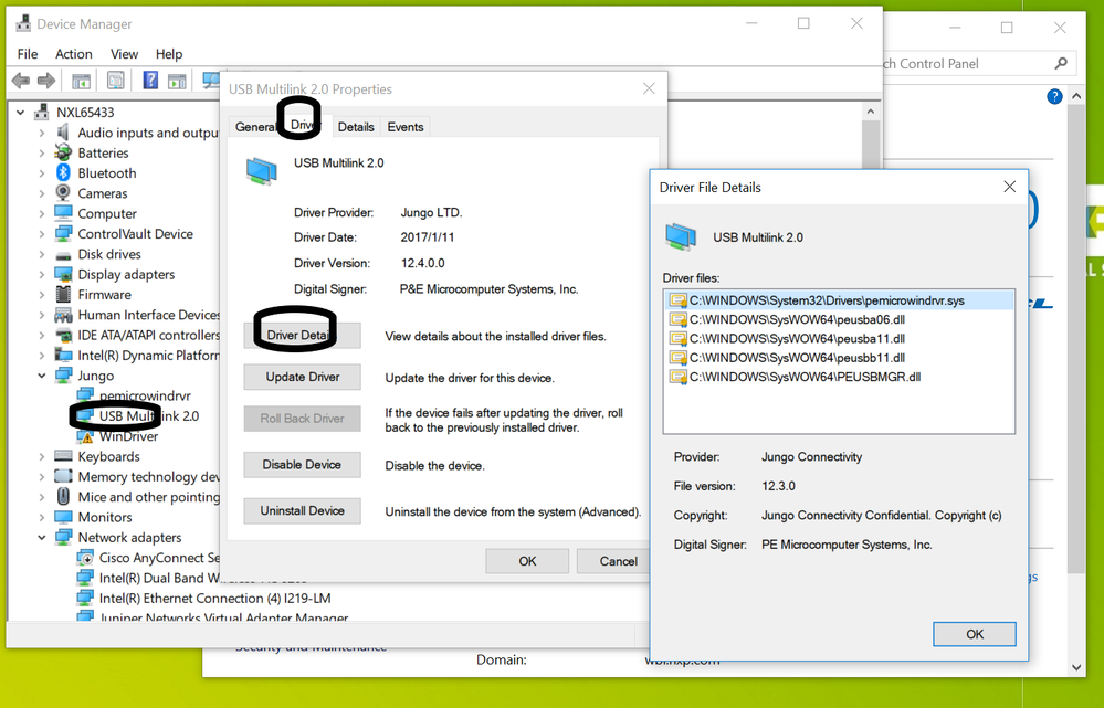

engineer12
Hi Kamil,
I am trying to run the example code, which runs on another 2 computers operating on Windows 7 and 8.1. I have tried running the CW11 on Windows 10 on 3 devices and it never worked! I always get the same error - P&E Connection Assisstant - An error occurred while connecting to the interface hardware.. (same as in the attached picture).
I updated the CodeWarrior to 11.0.1 but still no success. In the Device Manager under the Jungo section I can see: pemicrowindvr, USB Multilink 2.0 and WinDriver where the three drivers/devices are working properly and are updated to the last version.
I believe it is a driver issue, because the same configuration and code works well on windows 8.1 or win7.

xiangjun_rong
Hi, Ivan,
If you use TWR-56F8200 board and use Multilink Universal device, you have to open the J21 and J20.
XiangJun Rong
15,932 Views
xiangjun_rong
Hi, Ivan,
This is the Multilink Universal device usb driver on my PC, which install Win10 and CodeWarrior for mcu ver11.
I do not know if it is helpful for you.
XiangJun Rong
