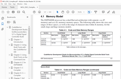

As the following screenshot in MCU_DSC_Compiler.pdf, if you use byte access in the application code and in small model, the address must be less than 0x7FFF.
The MCU_DSC_Compiler.pdf is located
......\Freescale\CW MCU v11.1\MCU\Help\PDF
Hope it can help you
XiangJun Rong
