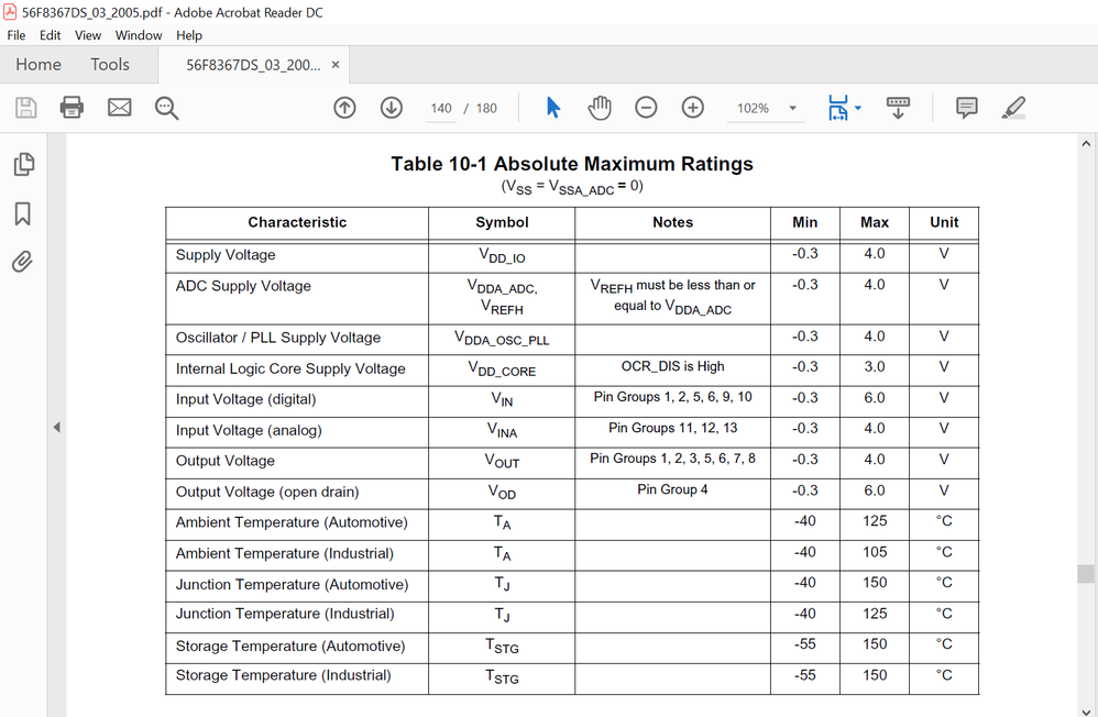

xiangjun_rong
Hi, Sasi,
Regarding your question, from the following table 10-1, we know that the input analog voltage ranges from -0.4V to +4.0V, the operating analog input voltage is from GND to Vrefh(it is 3.3V generally).
So you can not connect the 20V voltage to the analog pin directly, otherwise, the ADC may be damaged. If you want to test the 20V voltage, you can use a resistor divider and guarantee that the voltage to the analog ADC pin is in the range from GND to 3.3V.
Xiangjun Rong
