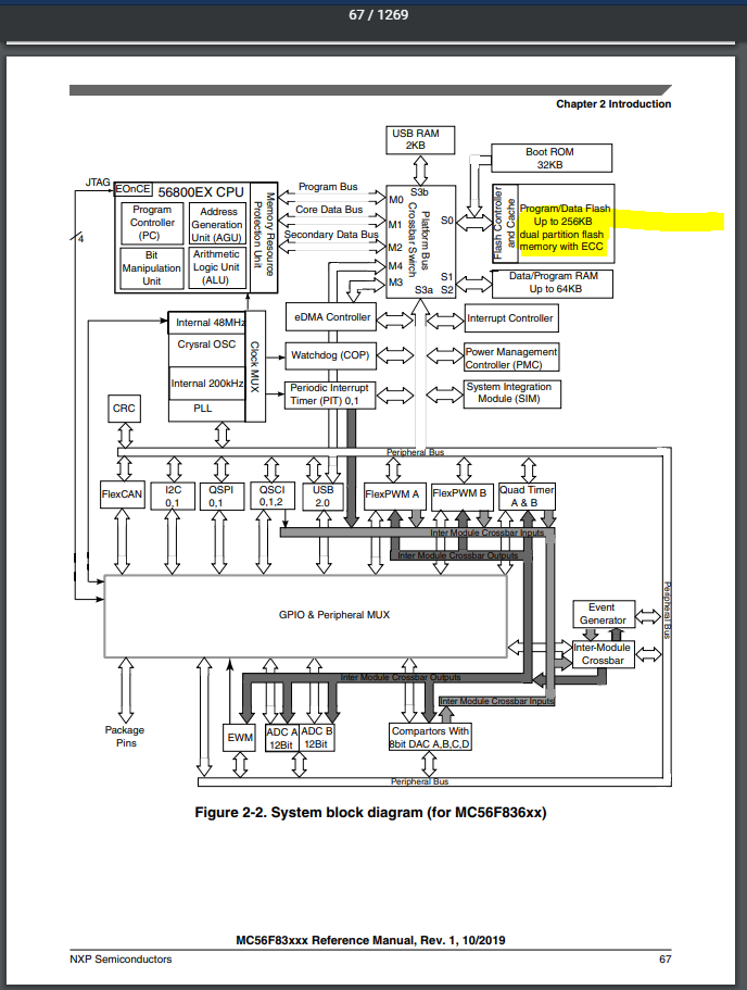

fasihahmed
Thanks.  xiangjun.rong‌
Can you be able to explain the meaning of dual-bank partition flash memory. I am new to this microcontroller family.
What are the advantages of using it? And do i need to configure anythign to be able to use the whole 256KB of flash for one big code image?

xiangjun_rong
Hi, Fasih,
I do not think the MC56F83xxx has dual-bank concept, pls refer to the screenshot. In other words, the primary program/data flash array1 and primary program/data flash array2 are continuous, you can save your large code to the two arrays which are total 128KW(256KB). Furthermore, you do not need to configure anything.
Hope it can help you
Xiangjun rong

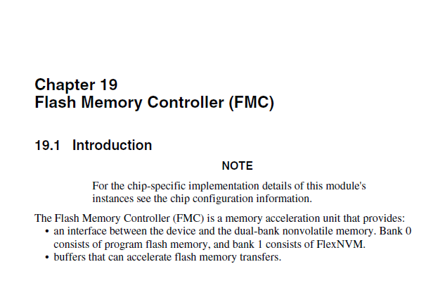

xiangjun_rong
Hi, Fasih,
Pls refer to the Chapter 19 in UM of MC56F847xx,the bank1 is FlexNVM, in other words, the bank1 is 16KW Secondary (boot) program/data flash memory , which can be mapped to both program space and data space.
XiangJun Rong

xiangjun_rong
Hi, Fasih,
I think you misunderstand the dual-bank concept foir the MC56F84xxx. As you know that the MC56F84xxx has Primary program/data flash, program/data RAM,secondary(boot) program/data flash memory.
The following fig is the memory map for MC56F847xx.
memory type                                                                              size                         address
Primary program/data flash                                                 128KW                 P:0x00 0000 - 0x01 ffff
Secondary (boot) program/data flash memory                  16KW                 P:0x06 8000 - 0x06 bfff
Program/data RAM                                                                   16KW                P:0x06 0000 - 0x06 3fff
The Primary program/data flash from P:0x00 0000 - 0x01 ffff are BANK0, Secondary (boot) program/data flash memory from   P:0x06 0000 - 0x06 3fff are bank1. So they are NOT consistent, they are independent. The Secondary (boot) program/data flash memory can be used boot memory and data memory.
