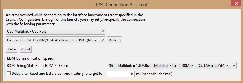

Hi, I have a problem with my processor mc56f8257.
Description: - I uploaded a new program
                  - I launched debug mod
                  - I accidentally pressed the reset button
Since then, the board is frozen and can not communicate, but it is to load a new bootloader.
I use - USB cable to connect the MCU
        - Eclipse code warior
I attach a photo of the error message and I apologize for my English.
Thanks for any tip.

sutter_zhou
Are you using CW10.4 or CW10.5? The best way is to refresh the firmware of JM60 on the TWR. If you're using a CodeWarrior whose version is older than 10.5, you can install CW10.5 and connect the board, it'll ask you to refresh the firmware through the bootloade when you dowload the code.
