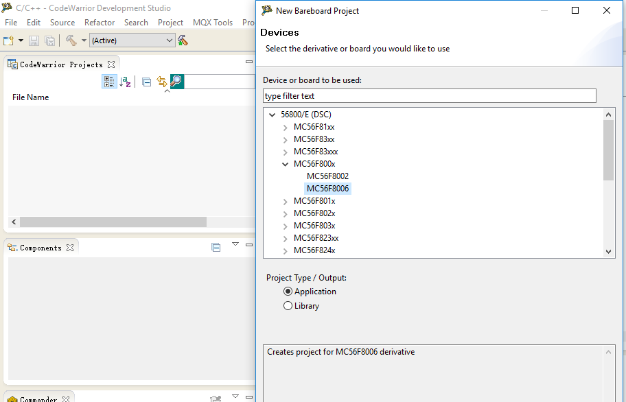

miladfozooni
i installed last version of codewarrior and my problem solved.
but in quick start tool version r2.7 , do not support mc56f8006 and i must instal quick satrt version 2.5
but i can not find it.
can you put a link of quick start tool version 2.5 ??
i attach a picture of supported device in r2.7 version.
thanks

xiangjun_rong
Hi, Milad,
Pls refer to the following section, you have to install the "DSC56800EX-QUICK-START" to the CodeWarrior for Microcontrollers CodeWarrior Development Studio V11.1 (or later)  rather than the Codewarrior for DSP56800E version 8.3(classic). The Codewarrior for DSP56800E version 8.3(classic) is very old.
XiangJun Rong
From the UM of "DSC56800EX-QUICK-START:
1.2.1 CodeWarrior for Microcontrollers CodeWarrior Development Studio V11.1 (or later) is a complete Integrated Development Environment (IDE) that provides a highly visual and automated framework to accelerate development of the most complex embedded applications. CodeWarrior for Microcontrollers integrates the development tools for the ColdFire®, ColdFire+, DSC, Kinetis, Qorivva, PX, RS08, S08, and S12Z architectures into a single product based on the Eclipse open development platform. Eclipse offers an excellent framework for building software development environments and is a standard framework used by many embedded software vendors. As previously mentioned, DSC56800EX_Quick_Start tool is designed for and can be integrated with CodeWarrior for Microcontrollers development tool. With CodeWarrior for Microcontrollers tool, users can build applications and integrate other software included as part of the DSC56800EX_Quick_Start release. Once the software is built, CodeWarrior tools allows users to download executable images into the target platform and run or debug the downloaded code. To install CodeWarrior for Microcontrollers V11.1, it is recommended to use the installation guide attached to the actual version of CodeWarrior for Microcontrollers, if available.
