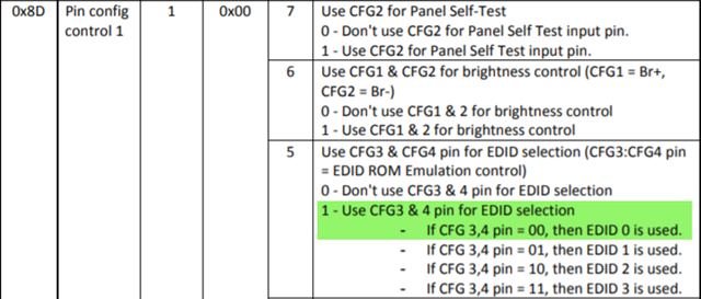

In my opinion it is strange that the chip presents to the GPU with 800 x 480 @60Hz resolution (it seems that it is using EDID 1) but we have not made any change.
I have no further ideas how to set it in the correct way. Please could you be so kind to tell me which is the correct way to configure the chip in the way to use EDID0 (1024 x 768 @60Hz resolution) using your DPCD M Tool (so configure the chip through DP AUX channel), because we have no possibility to configure it via I2C? I have tried, but I was no able to write any memory cell.Moreover, pleae could you be so kind to write me the meaning of the address that I inset in the DPCD M Tool: is it the address in the SRAM or the equivalent used in the I2C communication?

Hi Fracesco,
There is a way to select EDID 0 by setting bit 5 of register 0x8D (Pin config control 1) and connecting CFG3 and CFG4 pins to LOW…
*Image from page 20 of the application note AN11606: https://www.nxp.com/docs/en/application-note/AN11606.pdf
But, I'm not sure if this works fine for you since you mentioned that “we don't have planned to develop specific software to configure the chip”
I hope this helps.
