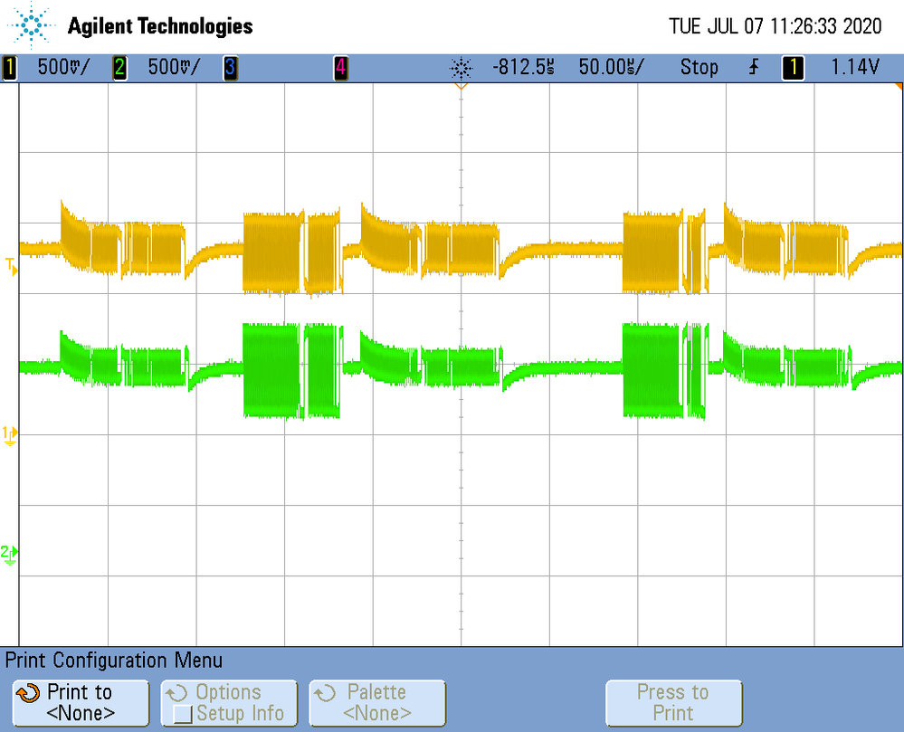

I have received a couple suggestions in case #00286817, mostly revolving around the DP AUX lines being properly terminated, but still no luck as of yet figuring out the exact problem.  We did discover an issue on our end regarding our termination resistors for the AUX+ and AUX- lines, which should now be resolved.
We also had adjustments made to our EDID to hopefully better reflect our AUO G215HVN1.0 panel.  The current EDID is below:
With this new EDID, the display appears in the device manager as "Generic Non-PnP Monitor", and still cannot be enabled in display settings.
After taking scope measurements of the AUXN and AUXP lines, we are finding that we should be in spec according to the datasheet, with a Common Mode voltage of about 1.2V and a peak to peak differential voltage of around 500mV.  We are noticing a little bit of swing in the common mode voltage (see attached scope captures).  Would that potentially cause an issue?
