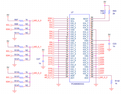

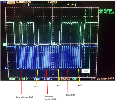

I am evaluating PCA9698DGG, but PCA9698DGG is not working.
You can see the waveform and schematic as like below.
The waveform capture conditions are below.
  1. SCL frequency : 400KHz
  2. Slave address 0x4E
  3. Command register : 0x08
  4. Data : 0xFF
  5. OE pin : GND
  6. MCU : ATMEGA128
Some strange thing is that SDA signal is very fast drop down after received ACK.
Also, I had changed SCL frequency and Slave address, but result is same.
Could you please help this issue?
Best regards.
JH Kim

Regarding to datasheet, output enable when OEPOL = 1.
But in my case, output enable when OEPOL = 0
Is PCA9698DGG datasheet correct on OEPOL and OE Pin?
JH Kim
2,788 Views
guoweisun
OEPOL bit controls the polarity of OE pin.
– OEPOL = 0: OE pin is active LOW.
– OEPOL = 1: OE pin is active HIGH (equivalent to OE pin).
when OEPOL set to 0,low OE active.

The pull up resistors are located at MCU side. The value is 1.5Kohm.
I think normal working I2C, but PCA9689 output is "0" level under below condition.
  4. Data : 0xFF
  5. OE pin : GND
  6. MCU : ATMEGA128
I think PCA9689 output is high level under upper condition.
I don't know what's wrong with no output.
Could you please adivce?
JH Kim
2,838 Views
guoweisun
1: What's the result when your drop down the frequency?
2:what's the pull up resistors of SDA/SCL of PCA8698?
