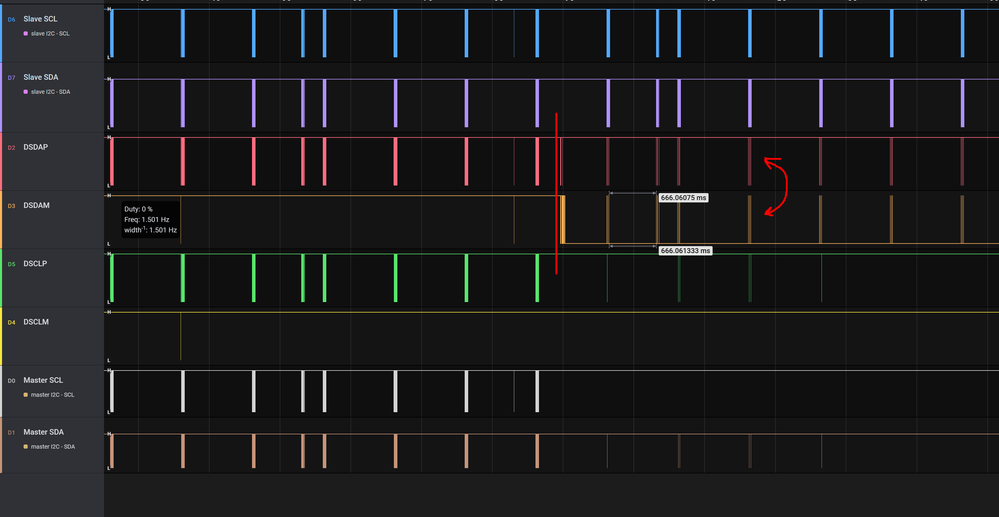

kvuurens
Hi Guo,
the decouple capacitor did the trick. Data is flowing. Got one question; I do not see the "differential" part of the dI2C like it is in the documentation, both for SDA and SCL:
When I remove the 100Ohm resistor (seen on the screenshot marked by the red stripe), I do see the differential part, but the data (obviously) stops flowing:

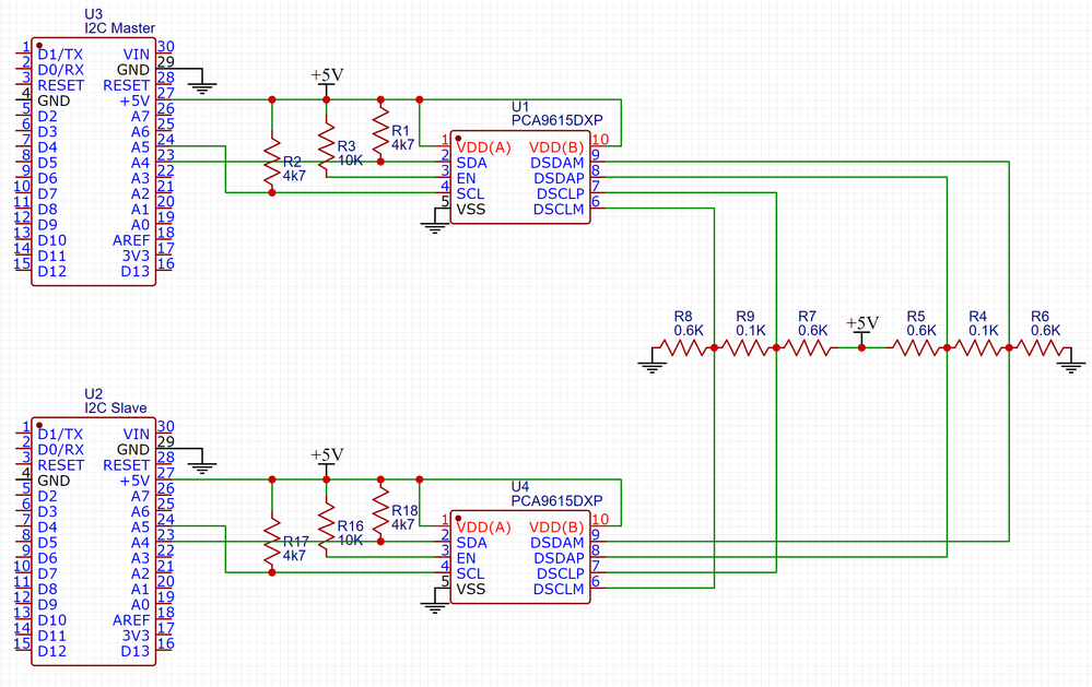

guoweisun
Please give your schematic here!
4,907 Views
kvuurens
Dear Guoweisun,
see below. I've only added one termination resistor set, as it's on the same breadboard, max 20cm apart from eachother. Currently not using twisted pair, but will be used in the final solution. All +5V and GND is on the same rail.

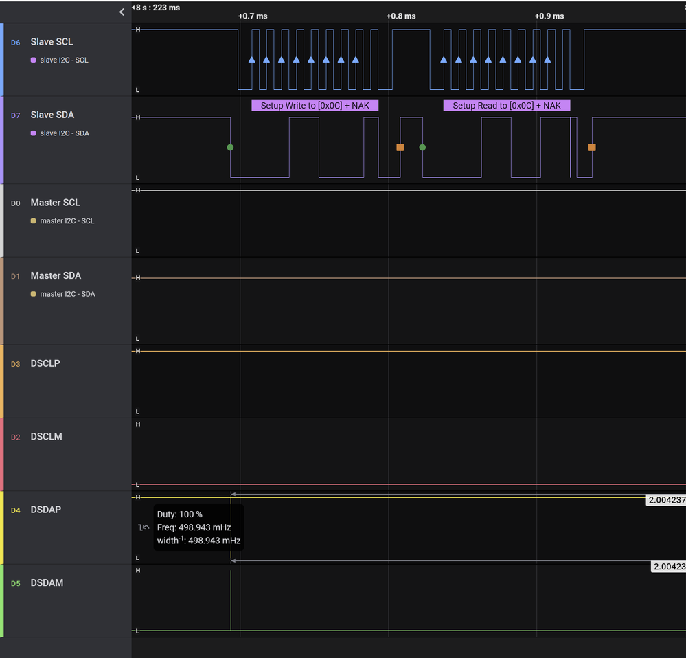

kvuurens
After using the logic analyser I see that the DSDA works, but the DSCL does not. DSCLM is low as you can see in the screenshot and DSCLP is high, as per the documentation.
The "slave" in the screenshot is actually functioning as a master using I2C terms, which is tring to get data from 0x0C (address 12). Any idea why the DSCL pair is not doing anything? I checked loose wiring etc, but could not find anything..
Also; the actual data part is empty as seen below on the screenshot:
To add; other chips have the same behaviour. Swapping SDA and SCL on the I2C side does result in the switching of the signal of the differential side (I2C SDA on SCL input, giving DSCL on the line).
4,968 Views
kvuurens
I debugged some more and after hooking the oscilloscope up to the output of the differential chip I do not see any activity on the line. Looks like the chip is not enabled?
