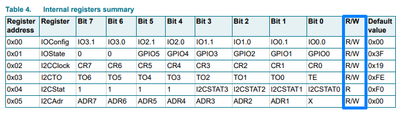

please note, that the last bit in the register is a read/write R/W bit. This bit must be different for writing and different for reading.
I presume the last bit for writing must be set to 1, you mentioned, you are writing 0xFF=0b1111 1111 and reading 0xFE=0b1111 1110. Please try to write first 0x0F=0b0000 1111 and second 0xFE=0b1111 1110. After that please read the register. You should read 0x0E=0b0000 1110, because the second writing should not change the higher four bits to 1.

The column you marked is for the type of the register not a bit.

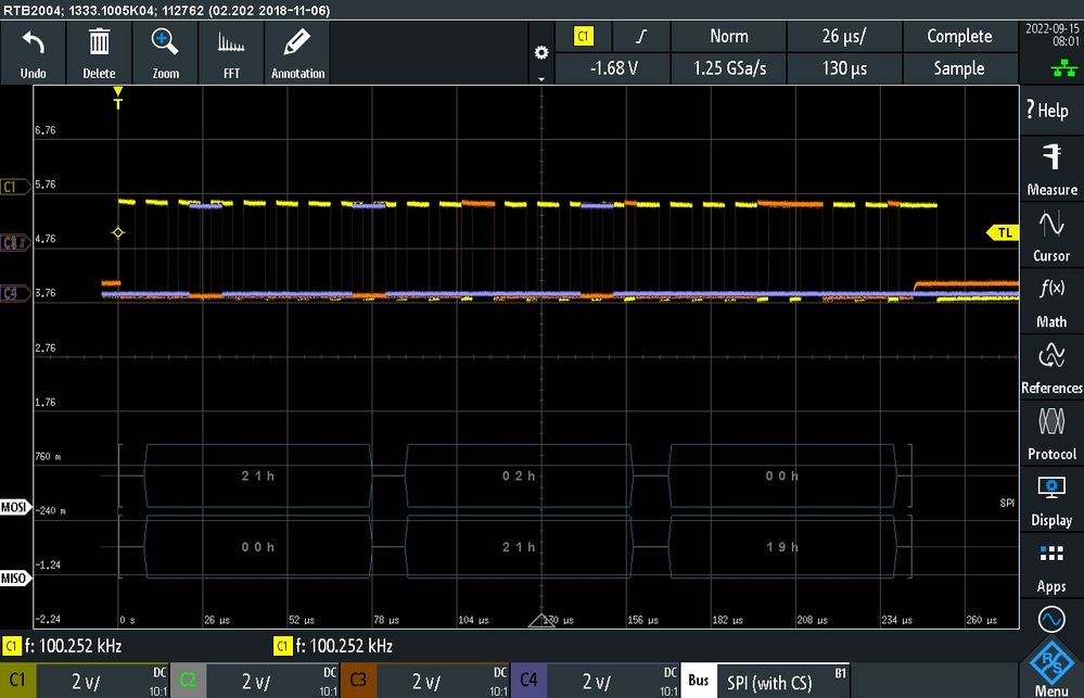

idanu357
Bellow is an image of the transaction.

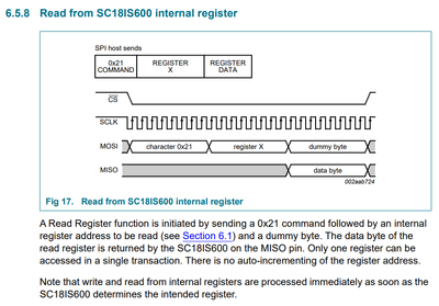

The datasheet is a bit misleading I hope you help me understand this:
1.What is the "Register data" after the register address, is that the data the sent back from the  SC18IS600 ?
2. What is the Dummy byte ? do I really need it ?
My MOSI lines are 0x2100 to read the IOConfig in half duplex or 0x210000 in full duplex
Reading SPI lines:
Without the dummy byte reading I2CClock register:
With dummy byte reading the IOConfig register.
6,193 次查看
JozefKozon
Hello Idan,
you are very welcome. And thank you for the scopes. Both look ok to me.
[A] The byte in the "Register data" is the content of the register, which address you enter in the second byte. After the command byte.
[A] Yes, you need the Dummy byte. It gives time to SC18IS600 to send the Register data to the MISO line.
In the first scope, you have the Dummy byte.
In the second scope, you have actually two dummy bytes and two Data bytes. Each on the MISO line each below one dummy byte.
Please check the pictures attached.
With Best Regards,
Jozef
6,168 次查看
idanu357
Thanks Jozef,
I can see that the SC18IS600 is returning the right data, but for some reason the last bit is missing when i read it via the FTDI chip(USB to SPI).
The data in the code is different from the scope im getting 0x02 instead of 0x03 or 0x18 instead of 0x19 and its consistent for every byte no matter how many bytes im reading from the SPI.
If you can see any problem in the scopes(?) i will continue to investigate the code or FTDI driver.
