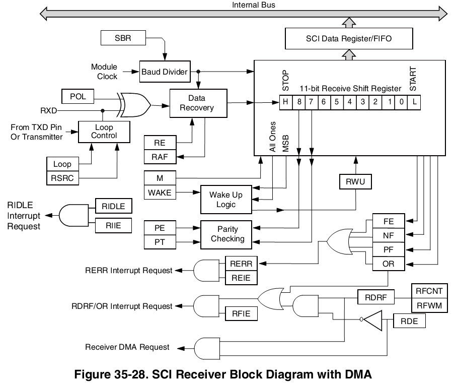

I have problem with DMA SCI on receiver idle interrupt.
I wrote the codes of SCI receiver by DMA  and it works well.
But when I try to add receiver idle interrupt, I can not find where the receiver idle interrupt vecteor is.
I have to search the whole <MC56F847xx Reference Manual> but no more information except bellows:

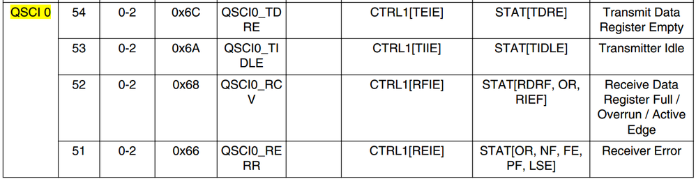

1.pngAt the middle-left of the Figure 35-28,  there is a receiver idle interrupt Request.
But it does not exist in Table 3-10. Interrupt Vector Table:
And I can not find any relative information in CodeWarrior PE.
Please help me, thanks.

xiangjun_rong
Hi, Jun,
Pls refer to the vector table, there are 2 interrupt vectors for the SCI0 receiver, so I suspect the idle interrupt of receiver is included in vector 51 or 52, especially 52.
You can have a try by generating the receiver interrupt and set a break point in two ISR and check which is entered.

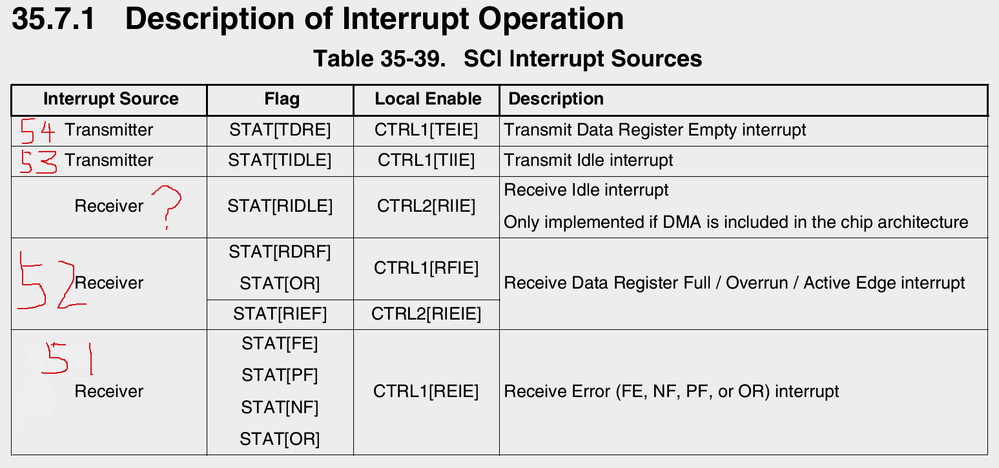

jero17
Mr. rong,
I have checked 51 and 52 many times, no one can be entered after Ridle flg set.
From Table 35-39 I attached days ago, I think there is an independent vector for Ridle.
thanks a lot

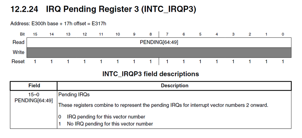

xiangjun_rong
Hi,WangJun,
How about checking the INTC_IRQP3 reg to know if the SCI receiver idle interrupt happens or not?

xiangjun_rong
Hi, WangJun,
I got feedback from design team, the SCI0 Receiver idle interrupt is not routed to interrupt table vector by mistake, so SCI0 receiver idle interrupt can not be triggered. We will document the issue in the errata.
Thank you for pointing the error.

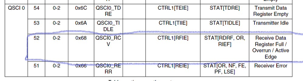

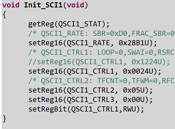

Hi, Mr.rong
I tested many times accordding to your suggestion.

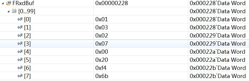

I enabled the RFIE & RIIE, and the DMA transported whole message correctly as below:
when a message ended, I checked the relative registors as bellow: RIDLE Flag is set.
but no any interrupt requist  pending up:

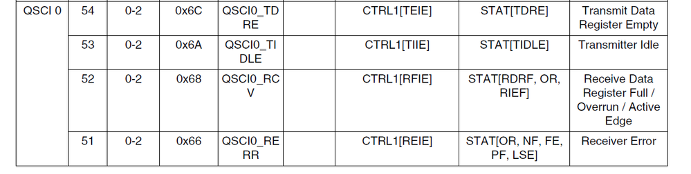

jero17
No any interrupt request.
