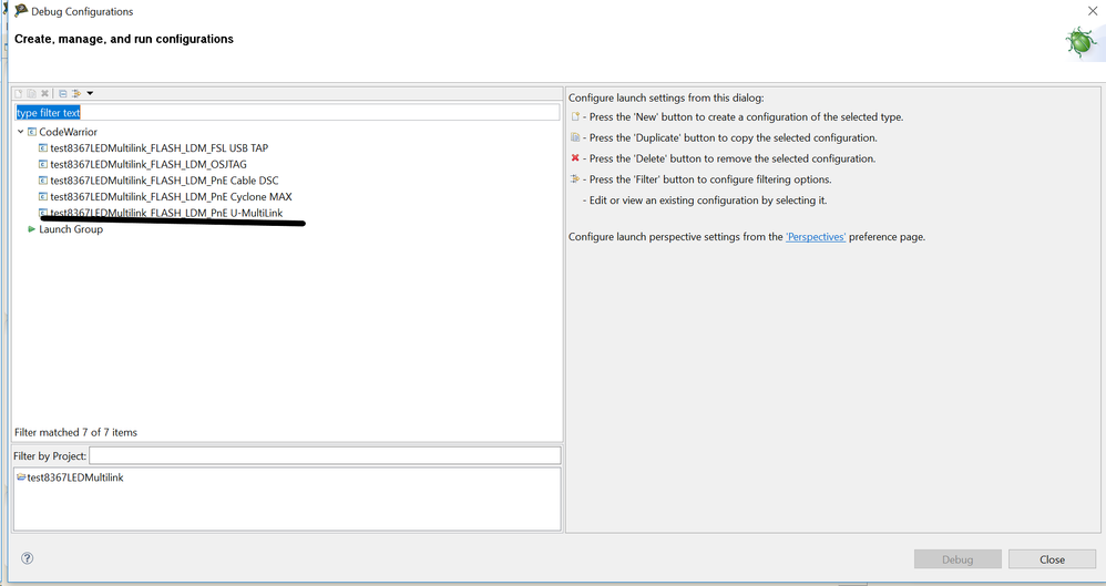

xiangjun_rong
Hi, Padma,
This is the configuration of CW for mcu ver11 tools for debugger. I have tried to connect CW for mcu tools with my MC56F8367EVM, I can success to connect the board with Multilink Universal device based on CW for mcu ver11.
Anyway, I suspect that your board design has issue. Because the MC56F8367 is very old, did your MC56F8367 target board work fine previously?
Xiangjun Rong
