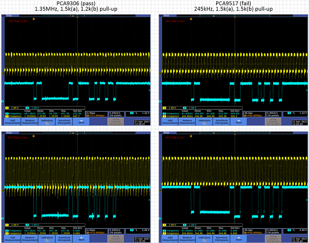

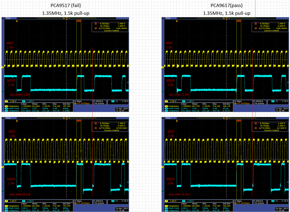

I am using the AR8035 phy connected to the LS1046A custom board.
I am using PCA9517 for level conversion between cpu(1.8v) and phy(3.3v).

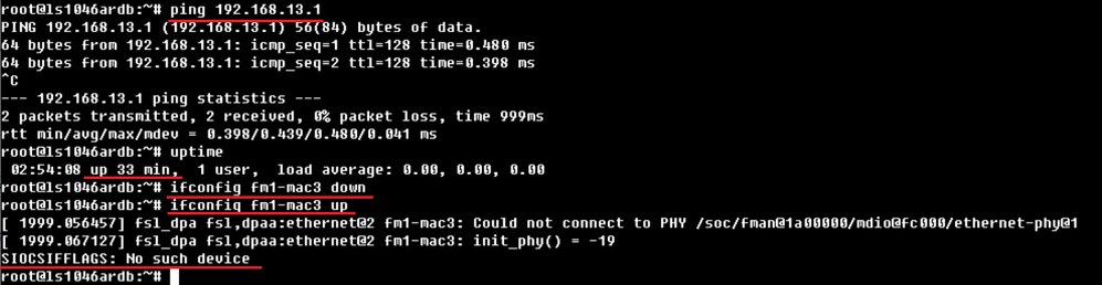

After applying the power and after a certain period of time, ifconfig fm1-mac3 down/up, there was a phenomenon that the up did not work, and when I checked it, I found that there is a problem with the level converter between the cpu and the phy.

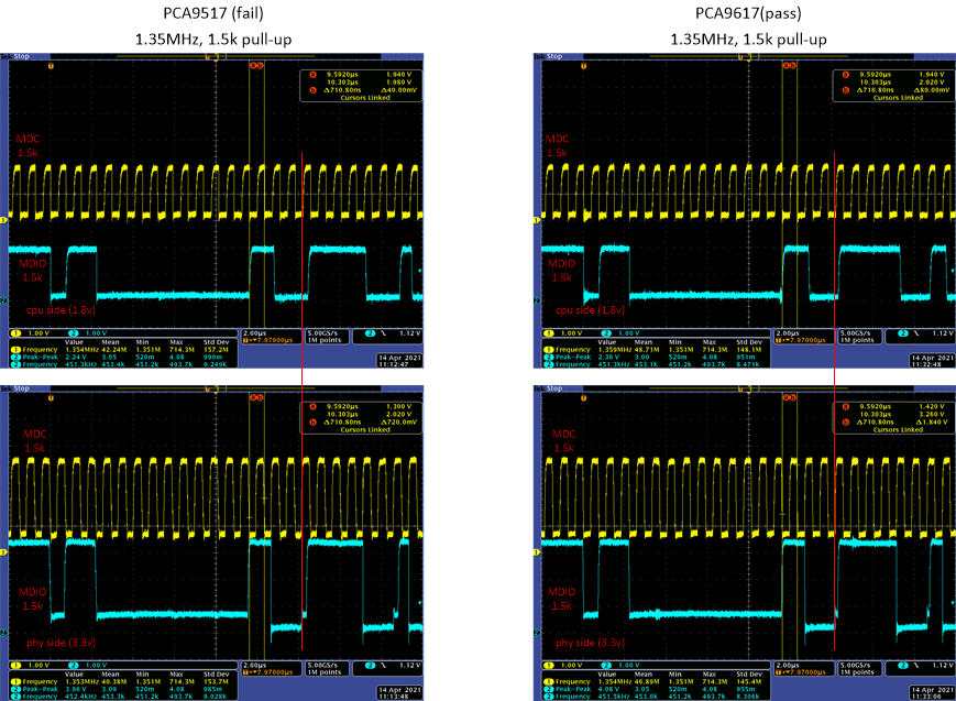

There was no problem after testing after replacing PCA9617 as a pin compatible replacement.
When I take the waveform, there seems to be no difference as follows, but PCA9517 is fail and PCA9617 is pass, but I cannot find a clear cause, so I ask a question.
Can I use PCA9517, which was reviewed as a replacement from a long-term perspective,
If so, I would like to know the answer for what reason was solved.

ufedor
Provided traces are not clear enough.
Please provide them in full resolution.
9,821 Views
Gyosun
9,818 Views
ufedor
PCA9617 has significantly higher operation frequency - refer to the presentation:
https://www.nxp.com/video/nxp-semiconductors-i2c-pca9517-to-pca9617:NXP-I2C-PCA9517-TO-PCA9617
It is required to lower MDC frequency to 400 kHz for PCA9517.

When using 9517, I had symptoms even if I lowered the A/B side pull-up resistance to 1.5k and the MDC clock to 245khz.
Can't I use 9517 for smbus? Which part is the problem in terms of the waveform above?

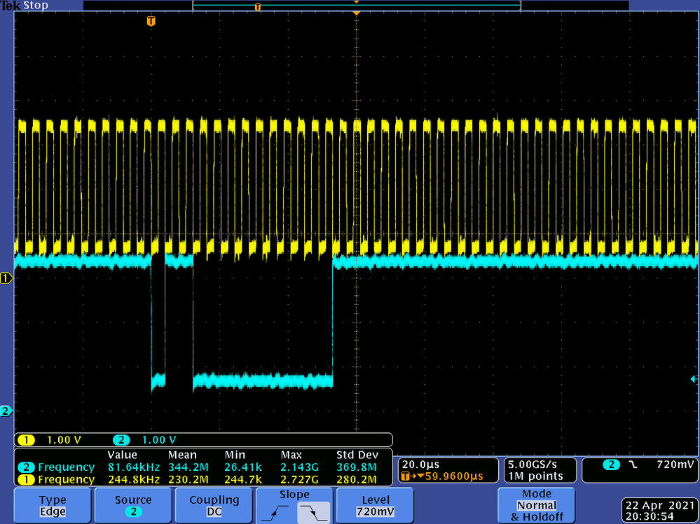

Gyosun

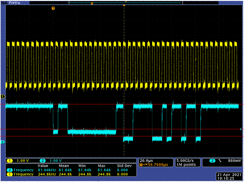

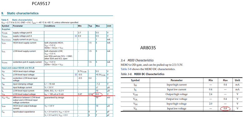

Even if I lower the MDC to 245khz, problems arise.
AR8035 low input is 0.8v max and PCA9517 vol max is 0.6v.
It comes out up to 0.8v. Could the VOL level be an issue?

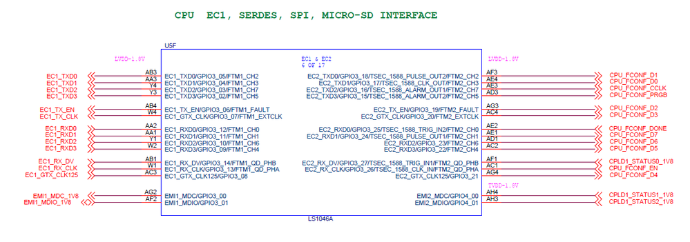

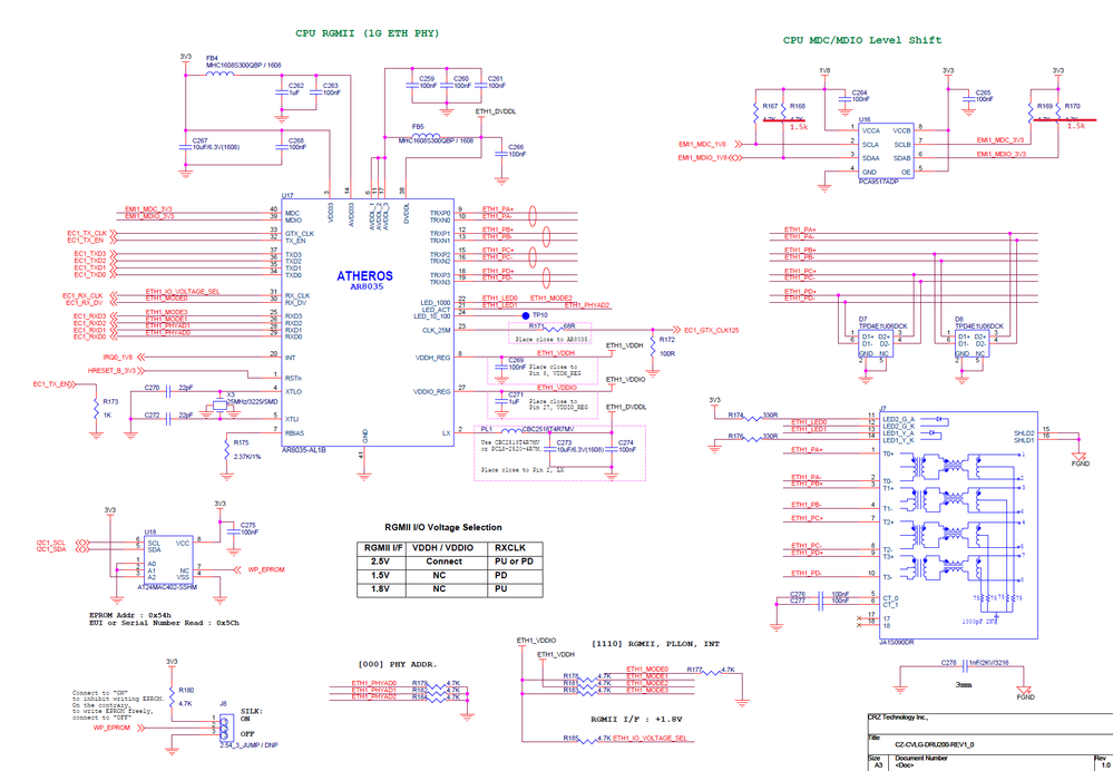

Please provide the PCA9517 connection schematics.
9,783 Views
Gyosun
I attach a schematic diagram.
Pasted Image 2021-04-22 16-59-03.pngPasted Image 2021-04-22 16-59-03.pngPasted Image 2021-04-22 16-59-24.pngPasted Image 2021-04-22 16-59-24.png
9,777 Views
ufedor
Use 3kOhm resistors for R169 and R170.

ufedor
Please disconnect EMI1_MDIO_3V3 from AR8035 and capture a trace.
9,763 Views
Gyosun
The MDIO was separated and captured from the AR8035.

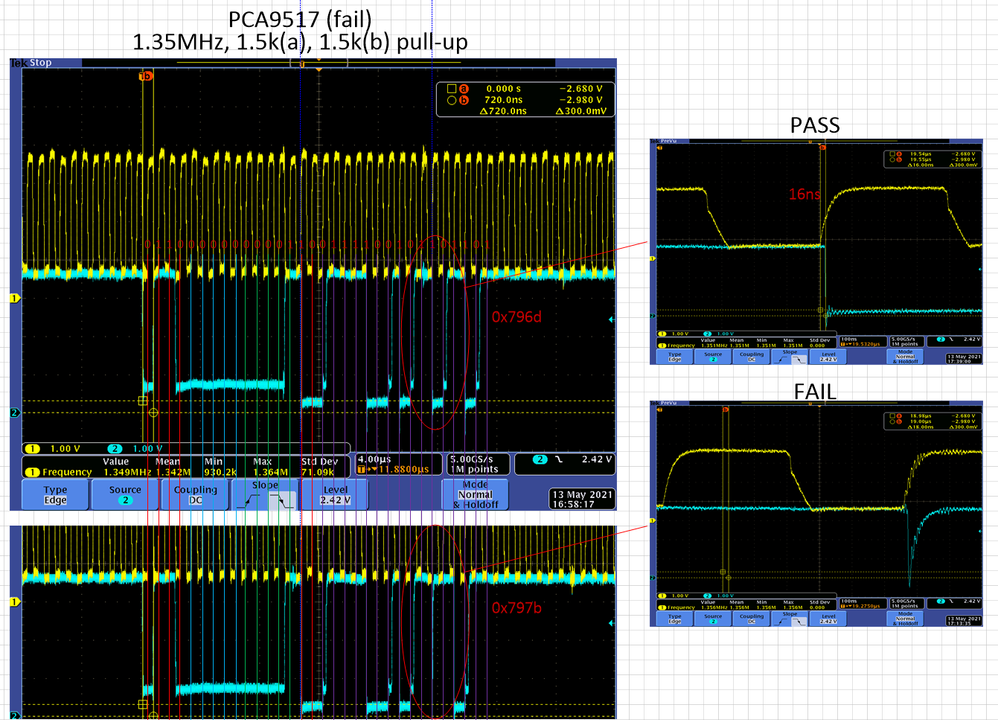

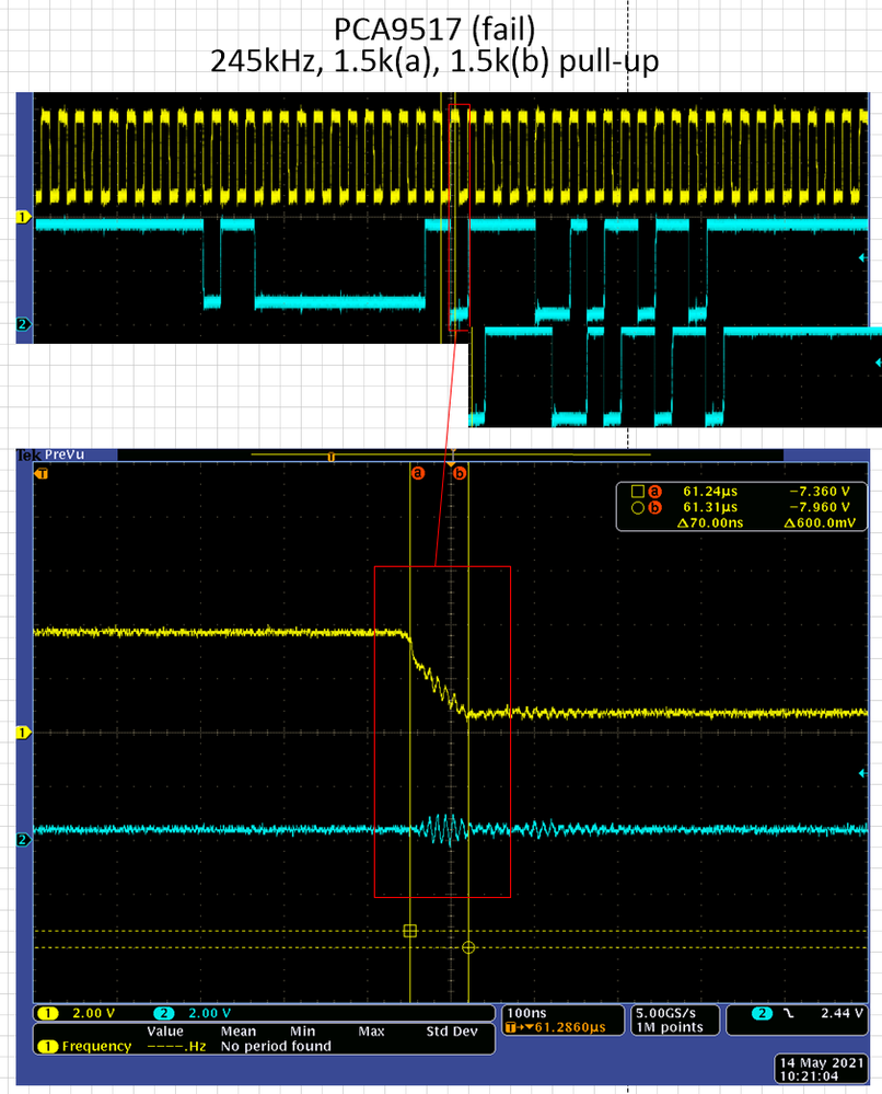

Gyosun
Found a suspected phenomenon.
If you look at the waveform of the MDC clock when it is abnormal as follows, it is not clean.
At this time, it seems to have an influence on the data received value by recognizing the clock.
If you have any opinions and countermeasures, please reply.
