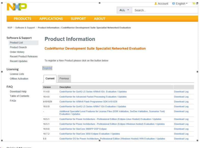

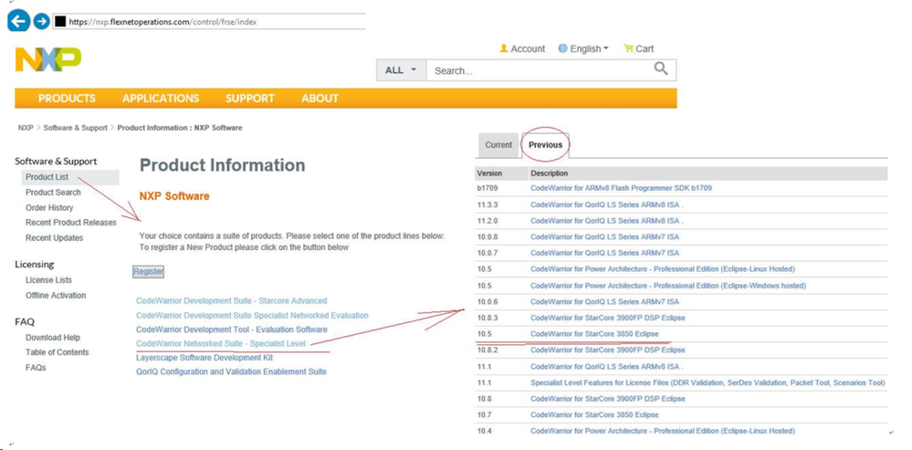

michael_keezer
The CW 10.5.1 in this list are for Power Architecture and NOT StarCore MSC8156…
The CW 10.7.2 is for StarCore 3850…
Again I logged into NXP.com (i.e. I’m registered) and still can not find the
CodeWarrior Development Studio for StarCore DSPs v10.5.x (like 10.5.1)
In the above list…

xiangjun_rong
Hi, Michael,
The CW for SC V10.7 is for BSC913x. To debug MSC815x please use CW for SC V10.5.x (the latest is 10.5.1).
Hope it can help you
XiangJun Rong

michael_keezer
Where can I get CodeWarrior Development Studio for StarCore DSPs v10.1.5? since Freescale.com does not exist anymore and the MSC8156EVM Software Installation Guide refers to CW SC 10.1.5 to use… I know its old but its what the doc says to use so maybe that the version of CW that works with the SDOS sample/example projects.
22,158 Views
michael_keezer
The only CW I can find is “CodeWarrior Development Studio for Power Architecture v10.5.1 – Windows.exe” which is for the Power Arch and not the StarCore MSC8156… Where can I get the CW for SC V10.5x (latest 10.5.1) your talking about?
