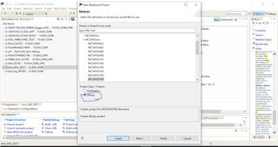

xiangjun_rong
From your description, it appears that you want to develop your own library, this is the procedure:
1)File->New->bareboard Project, you will se the menu as following:
2)in the main.c, delete all the main function
3)add your own api function and compile.
Hope it can help you
XiangJun Rong

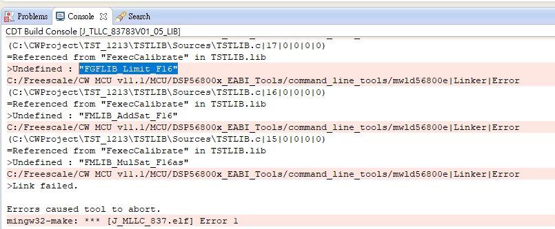

cody1
I follow your step to create a library like the attached file. I pasted the output file of the library to my application project, then I build it again. I got a fail message. The message is shown below.
5,225 Views
xiangjun_rong
I have checked your code, it is okay to generate library.
But for your compilation error, it is another question, I do not have your data structure, pls solve it yourself.
