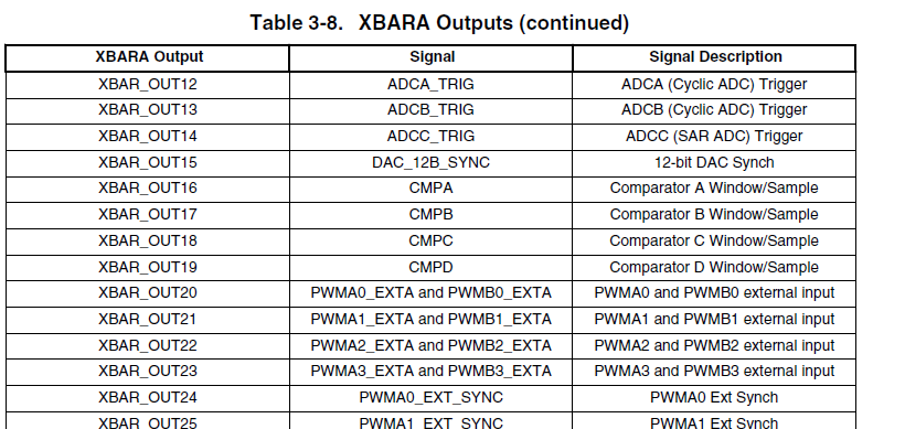

I am attempting to get the ADC12 and ADC16 to trigger from the PWMA output of SM0, SM1, and SM2 modules.  I have set the XBARA_SEL0, 1, 2 registers to map the pwm module's PWMA output to the ADC input, and similarly for the PWMB and and the ADC16.
    XBARA_SEL0 = 0x140C;
    XBARA_SEL1 = 0x160D;
    XBARA_SEL2 = 0x180E;
When I run the code, the PWMA_SMxTCTRL register reads 0x0004 instead of 0x8004 (which is supposed to be setting the trigger for PWMA as a trigger).  The code does attempt to set the bit in PWMA_Init() in the PWMA.c module generated by ProcessorExpert (and similarly for SM1 and SM2),
  /* PWMA_SM0TCTRL: PWAOT0=1,PWBOT1=0,??=0,??=0,??=0,??=0,??=0,??=0,??=0,??=0,OUT_TRIG_EN=4 */
  setReg16(PWMA_SM0TCTRL, 0x8004U);
but it doesn't get set when I look at it using CodeWarrior.  Any idea what is wrong?  Is this even possible with this chip?

Hi, Peter,
Pls refer to the screenshot in the MC56F847xxRM.pdf, if you want to use PWMA0_Trig0 to trigger ADCA, this is the crossbar setting:
   XBARA_SEL6 = 20; //the 20 means XBAR_IN20,    XBAR_OUT12 is  the ADCA trigger
If you want to use PWMA_Trig0 to trigger SAR ADC
  XBARA_SEL7 = 20; //the 20 means XBAR_IN20
Regarding the PWMA triggering setting:
setReg16(PWMA_SM0TCTRL, 0x04U);     //use VAL2 to trigger, do not set the PWMAOT0 or PWMAOT1 bits
Hope it can help you
