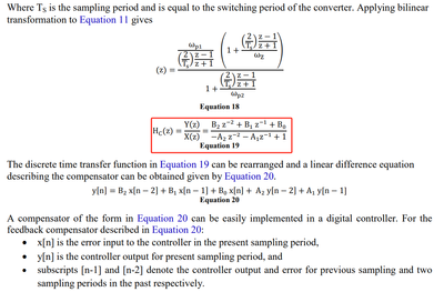

refer below picture, Equation 19, how to get B2、B1、B0、A2、A1、A0;
Do you need to consider decimal floating-point to fixed-point conversion? MC56F807xx series with FPU function, can be used directly?
Does MC56F807xx need to consider the interrupt delay in digital calculation, or the delay caused by other functional modules, and finally combine it into a phase delay? How do I feed back to Ax\Bx?
and What are the interactions in the adjustment process?
Is there an intuitive display tool? For example, you can plot a Bode plot;
Or can we only invert the s domain every time we change the values of Ax and Bx, and then draw the graph?
I am a little confused about this, and I would like to ask you to help me sort out and answer questions.

Q4)Or can we only invert the s domain every time we change the values of Ax and Bx, and then draw the graph?
The Ax/Bx is only dependent on the transfer function in S domain and the sampling rate, after the transfer function is determined, sampling rate is determined, Ax/Bx are determined.

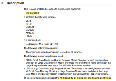

Q1)Do you need to consider decimal floating-point to fixed-point conversion? MC56F807xx series with FPU function, can be used directly?
>>>>>I suppose that you use fslesl library for the IIR filter:
https://www.nxp.com/design/design-center/software/embedded-software/real-time-control-embedded-softw...
For the DSP56800E and DSP56800EX core, the frac16 (fixed point) format is used. For the DSP56800EF core, it appears that the library only supports frac16/frac32 (fixed point) format rather than float format.
【A】:
from https://www.nxp.com.cn/docs/en/release-note/DSCRTCESL47RN.pdf ,I find below picture for your reference.
BTW, could you update/provide the documentation of algorithms User Guide for 56800EF? Currently, only 58600EF software *.exe files are available on the official website.

I agree with you that the DSP56800EF Real-Time Control Embedded Software
Libraries release 4.7 supports 16-bit and 32-bit fixed-point and floating-point types, but the rtcesl documentation has not be updated yet.

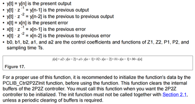

I learned AN4716.pdf, which mentioned the 2p2z digital compensation loop, and then you can use, reference 56800EF_RTCESL_4.7->DSP56800EFPCLIBUG; page12, use the function PCLIB_Ctrl2P2Z_F16
Question 1: f16DelayX1, f16DelayX2, f16DelayY1 and f16DelayY2 are mentioned in 2.1.2. How should I understand them?
Problem 2: The equation described by reference to 2.3 GDFLIB_FilterIIR2 in 56800EF_RTCESL_4.7->DSP56800EFGDLIBUG is equivalent to 2p2z(PCLIB_Ctrl2P2Z_F16); So, can I use GDFLIB_FilterIIR2_F16 instead of PCLIB_Ctrl2P2Z_F16? Are the two functions equivalent, or is there any special optimization of PCLIB function PCLIB_Ctrl2P2Z_F16?

我学习了一下AN4716.pdf,里面提到了2p2z 数字补偿环路,然后可以使用,参考56800EF_RTCESL_4.7->DSP56800EFPCLIBUG;page12,使用函数PCLIB_Ctrl2P2Z_F16
问题1:在2.1.2中提到了f16DelayX1、f16DelayX2、f16DelayY1、f16DelayY2 这4个参数,我应该如何理解呢?
>>>>>这几个是变量, 不是参数。
比如输入序列是x0 ,x1, x2, x3, x4 ,x5, x6,...
比如输出序列是y0, y1, y2, y3, y4, y5, y6,....
y6=a1*y5+a2*y4+b2*x4+b1*x5+b0*x6. 在此情形下,这是对应关系:
f16DelayX1 is x5
f16DelayX2 is x4
f16DelayY1 is y5
f16DelayY2 is y4
问题2:参考56800EF_RTCESL_4.7->DSP56800EFGDLIBUG中的2.3 GDFLIB_FilterIIR2描述的方程和2p2z(PCLIB_Ctrl2P2Z_F16)是等价的;那么,我是否可以使用GDFLIB_FilterIIR2_F16 来替换PCLIB_Ctrl2P2Z_F16呢? 两个函数是否等价,或者说PCLIB中的函数PCLIB_Ctrl2P2Z_F16有啥特别的优化吗?
>>>>由S域到Z域用到了双线性变化,因此GDFLIB_FilterIIR2和2p2z(PCLIB_Ctrl2P2Z_F16)是等价的
