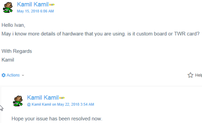

mohammad_kamil
Hello Ivan,
May i know more details of hardware that you are using. is it custom board or TWR card?
With Regards
Kamil

mohammad_kamil
Hope your issue has been resolved now.
