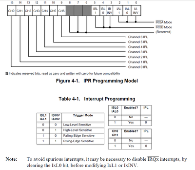

I checked the documentation of EVM and found the IRQA and IRQB are pull up, and our programming tool is floating on IRQA and IRQB pins.
is it possible IRQA and IRQB cause programming issue if they are floating?

May i know how to disable the IRQA&B via Once JTAG?
Any source code for reference?

xiangjun_rong
#include "DSP56F807_peripheral_regs.h"
You can use either
asm(bfclr #$0012,X:0xFFFB);
or
asm(bfclr #$0012,X:IPR);
The IPR is defined in "DSP56F807_peripheral_regs.h"
Hope it can help you
XiangJun Rong
7,676 Views
xiangjun_rong
I suppose that what you want is to disable IRQA/IRQB interrupts, you'd better write IPR register by clearing both IAL0 bit and IBL0 bit, pls refer to section 4.7 Interrupt Priority Register (IPR) in user manual of DSP56F801~7.
It is okay to connect a pull-up resistor on both IRQA/IRQB.
XiangJun Rong
