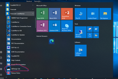

xiangjun_rong
I think you can use the Matlab tools to get the response either in frequency domain or in time domain.
We have a free tools to get the frequency response,Qedesign lite.
You can download the CodeWarrior for 56800E ver8.3, after you install it, the Qedesign lite will appear as above screenshot.
You can download the CodeWarrior for 56800E ver8.3 from the link:
https://www.nxp.com/design/software/development-software/codewarrior-development-tools/codewarrior-l...
Hope it can help you
