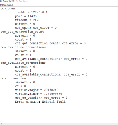

I am using Codewarrior ver11.1 for development of MC56F8367 DSC along with USB TAP for debugging.
I have Windows 11 installed on my computer.
When I try to run the debugger, I am getting the 'CCSProtocolPlugin' error during the connection stage itself.
I am not able to open CCS.exe either to send commands and verify the connection.
Can you please help me resolve this error and understand why the connection would not happen ?
Is Codewarrior 11.1 compatible with windows 11 ?
Thank You !

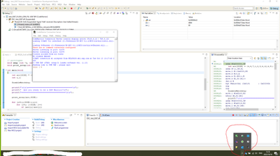

2,748 Views
SGatDGI
Yes I am able to see the CCS console opened up now ( by doing ' show Console ' to the minimized CCS Server logo ).
The debugging also works now. Although it requires to power cycle the target in order to get no errors while the debugger is connecting / downloading the code.

2,833 Views
SGatDGI
If I enable the CCS executable as part of project ( Run/Debug ) properties I see the following in the codewarrior console. The CCSPRotocolPlugin error still remains.
