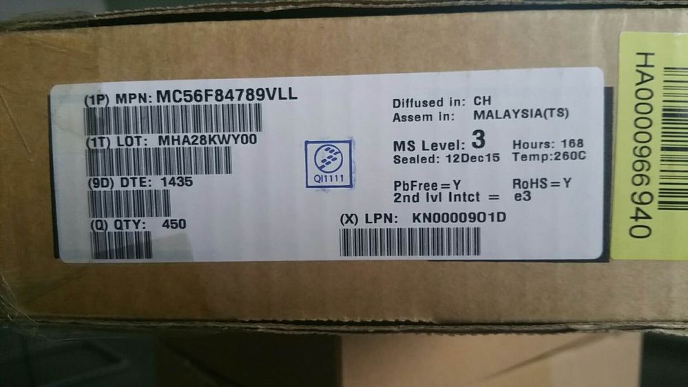

ruvimelaver
Hello ,
Please advise date code of the part .
Ruvi
2,598 Views
jero17
I am looking forward to your suggestion.
Wang Jun
2,598 Views
mohammad_kamil
DTE: 1435 indicates it  year 2014, 35th Week of manufacturing
