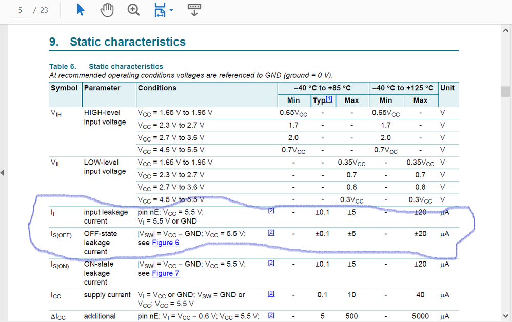

Hi, we have chosen 74LVC4066BQ chip and need to provide Pullup resistor in enable pin's (nE).
So please share the nE pin required current details.
Not able to identify the value in datasheet.
Thanks & Regards,
Rajan
1,516 Views
xiangjun_rong
Pls refer to the Il imput leakage current spec.
