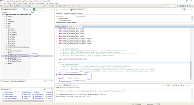

Hello
I saw in the documentations that it is possible to run the bootloader from the user application firmware. Anyone know how to do it?

xiangjun_rong
As you know that the FOPT register is loaded from the flash configuration field at address 0x40D in flash memory after Reset, so it is impossible that you write the FOPT directly in order to run from flash directly after next Reset. Instead, you have to write the FOPT location in flash configuration field.
For detailed inf, pls refer to section 6.3.2 Start-up Process in the MC56F83xxxRM.pdf.
In the SDK example, we provide flash_config.c and Flash_config.h, as the following screenshot, pls change the macro
#define FCF_FLASH_OPTION_BYTE 0xFFU
to
#define FCF_FLASH_OPTION_BYTE 0x7EU
The flash configuration field corresponding FOPT location will be changed.
the DSC will start running from flash directly.

Ben
Senior Contributor I
in the chip RM it is written: "Multiple options for executing the bootloader either at system start-up or under
application control at runtime". How do activate the bootloader "under application control at runtime"?

Ben
Thanks Rong, but I mean, is it possible to access the FOPT register from my application while it is running to set the register that next reset will run the bootloader, or the only way to change the reg. value is through the sdk programming / debugging?

xiangjun_rong
to

Ben
sorry, I did not see your last answer below. thank you for the support and for the detailed answer.
