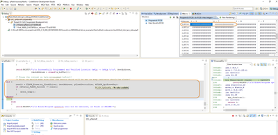

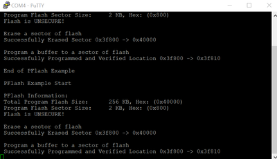

xiangjun_rong
I come to know your question. I run the PFlash example in SDK. This is the screenshot of PUTTY menu:
The address P:0x3_F800->0x4_0000 are Byte address, the real P flash address should be right shift by 1 bit. Or the real address is 0x1_FC00 to 0x2_0000

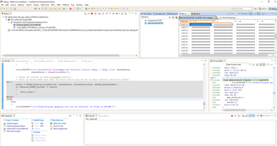

I checked the address of P:0x1_FC00
You can see that the P:0x1_FC00 has changed
You can see that X:3_FC00 also changed.
If it can not answer your question, pls update the ticket.
Hope it can help you
XiangJun Rong

saw your example. you wrote to P:1FC00 and saw the data at X:3FC00. it is normal as in the manual it is written that x:20000-3ffff is mapped from p:0-1ffff.
in my case, I am writing data to x:2A000 and see it at x:35000. reading x:2A000 gives 0.
