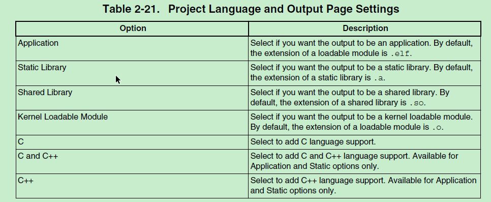

There are two application note about porting classic ColdFire project to CodeWarrior for MCU V10.x version.
Please check below link for the detailed info.
AN4727 & AN4104.
About create a static library, please refer CWMCUDBGUG document:
Wish it helps.
