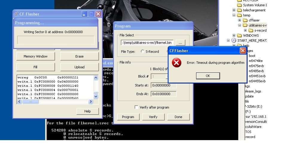

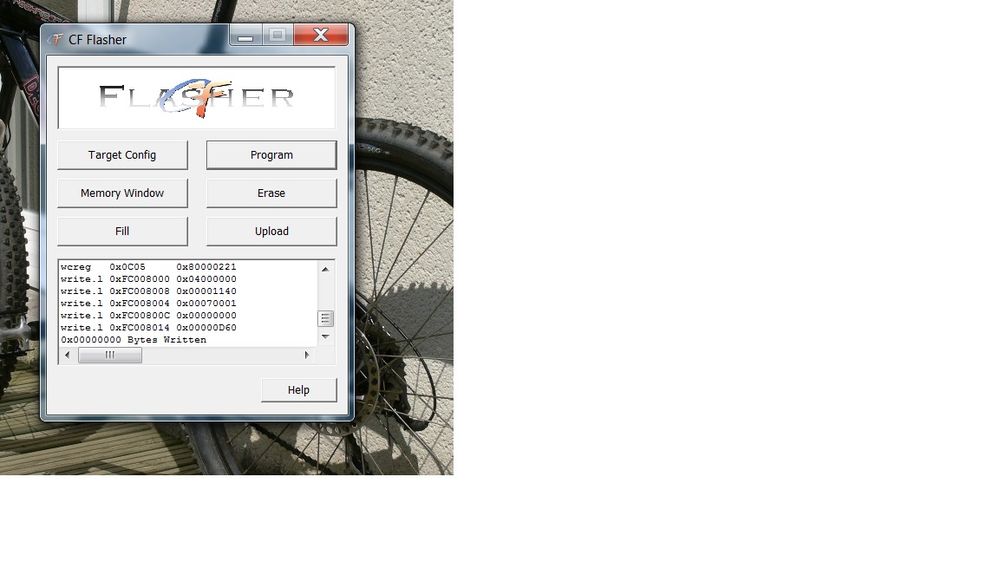

I accidentally erased u-boot.
I tried to flash u-boot.bin by CFflasher with the simple supplied USB cable and with the PE's driver.
I can see the contents of the memory flash (ie : 0400-0000 ...), but when I want to flash CFFlasher freezes and I've got a time-out.
I tried to flash by another soft. Impossible.
Any idea?
Thanks by advance.

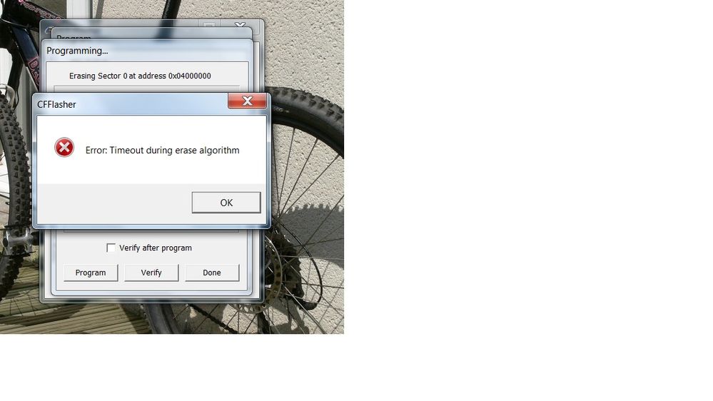

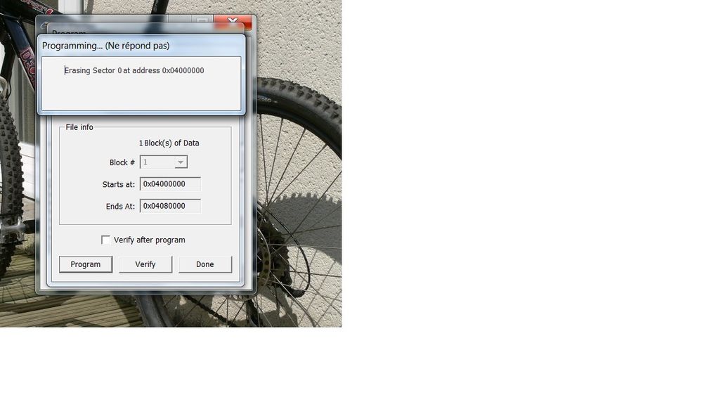

I can erase  0000-0000 -> 00FF-FFFF    (Intel 28F128J3D - 1*8 - Flash1(code))
I can't erase 0400-0000 -> xxxx    (Amtel AT49BV04A - 1*8 - Flash0(boot))
I can't fill Flash1 Flash0.
I can't program Flash1 Flash0
Impossible to write anything to flash-memory (bad data in one of the multuple registers of the µC).
Bad algo ... Don't know.
To be continued ...

In order for any debug-connected flash programmer to work, it has to "know" (meaning that someone has to properly configure it to understand):
  • Exactly which CPU model it is connected to and running on, including
  • How to set up various CPU control registers
  • How to set up the RAM (to load the flasher into), and what address it is at
  • How to set up the CPU Clocking system (depends on supplied clock sources)
  • How to set up any other memory controllers
  • How to disable or pat any internal CPU watchdogs
  • How to set up the chip select decoders for the external FLASH chips
  • That was the CPU-specific stuff. Then there's the board specific stuff, like
  • What clock sources are available, and what frequency the crystals are
  • What other peripherals might be present, like an FPGA that might need to be handled.
  • Are there any external watchdogs?
  • What external Flash chips are connected to what chip select decoders
  • How wide the Flash chips are (8/16/32 bit)
  • Exactly what brand and model the Flash chips are, so as to use the right algorithm
This is very hard to set up unless you're the designer of the board. You can only really trust this to work if the board was provided with a working flasher setup and the proper configuration files to allow a specific programmer to run.
If the board came with all of that, then it should work. If it didn't, then unless you have a working one from someone else, there's a lot of things to get right.
I think you're better calling "warranty".

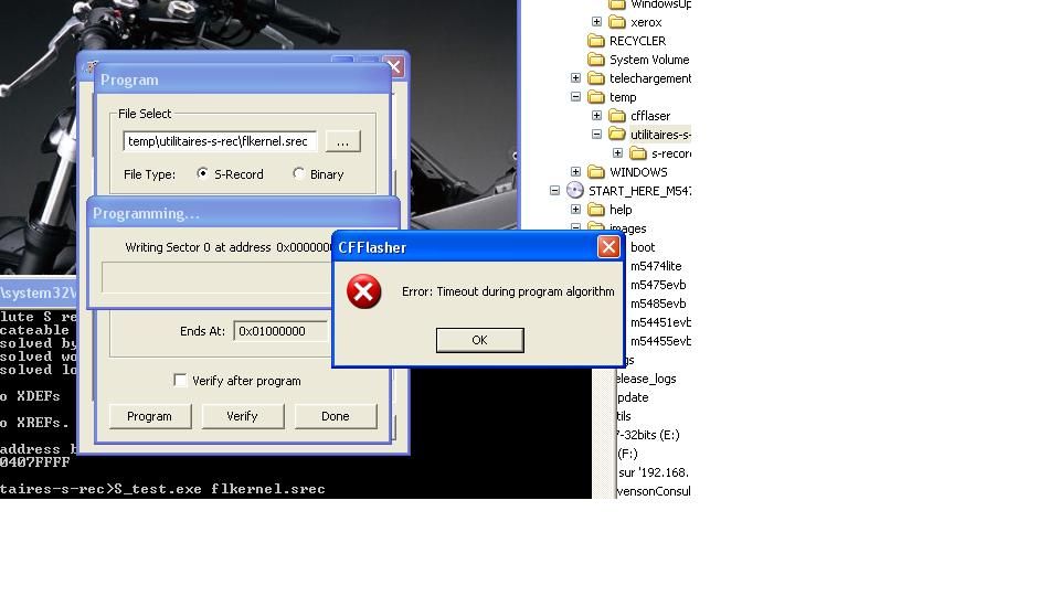

alainrohou
Hi Fang li,
Same error "time-out"

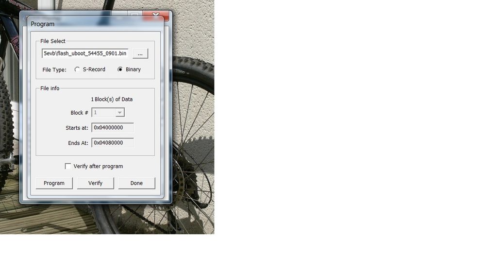

I program .bin file.
I tried to convert .bin to .srec by an utility found on the net "bin2srec.exe".
I'm not sure it's a good utility.
I can't fill memory.
I send you screen copies.
Alain

I think you should keep trying with the Win XP you have. If the erase works, but the programming doesn't, then you've probably got something set up wrong. Make sure you're addressing the right devices at the right addresses. Make sure the image you're trying to program is set to target the right address.
> When updating linux image, system crashed and erased the boot loader.
The Boot and Linux Image are in different FLASH chips at different addresses. I think you must have selected the wrong chip to work on somehow. Too bad the hardware doesn't have a jumper to protect the boot flash in hardware against "accidents". That's always a good thing to add to the design.

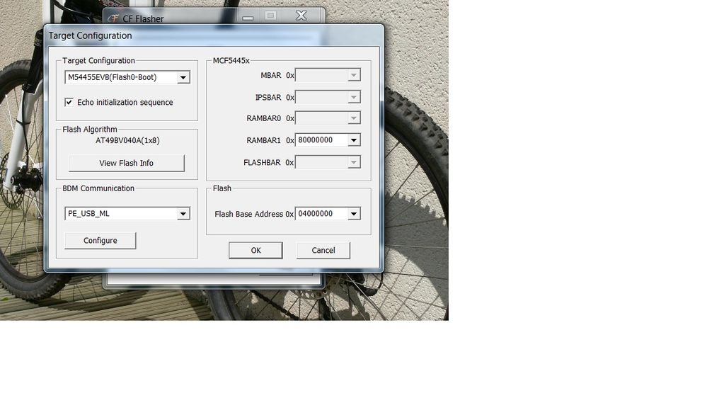

alainrohou
Hi Tom,
CFFlasher runs on Win7-32 bits.
Some screen copies:
config CFFlasher:

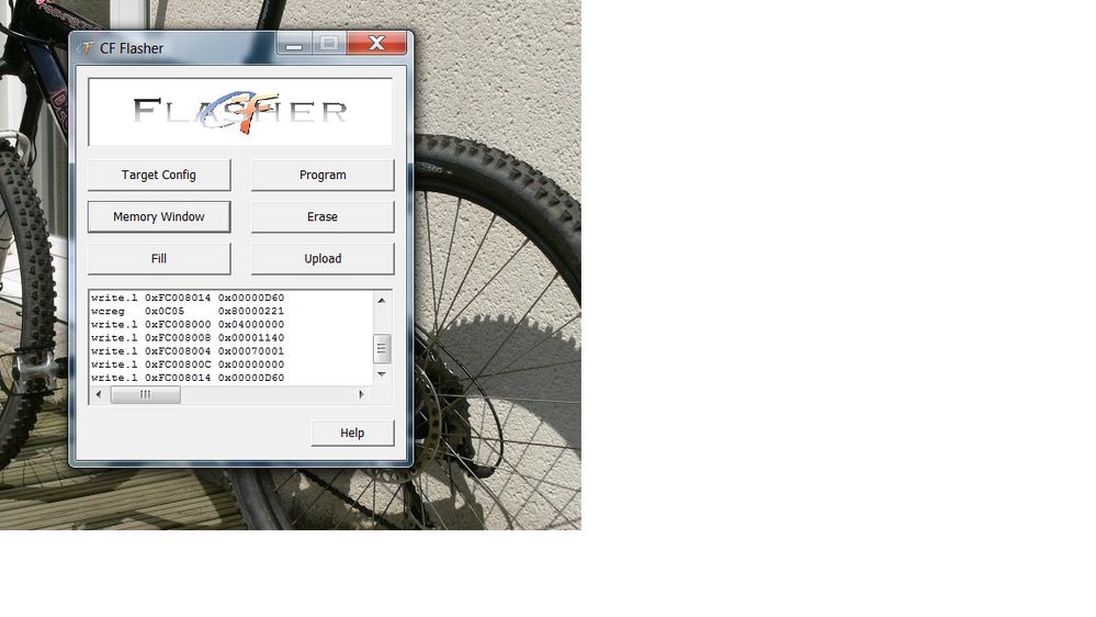

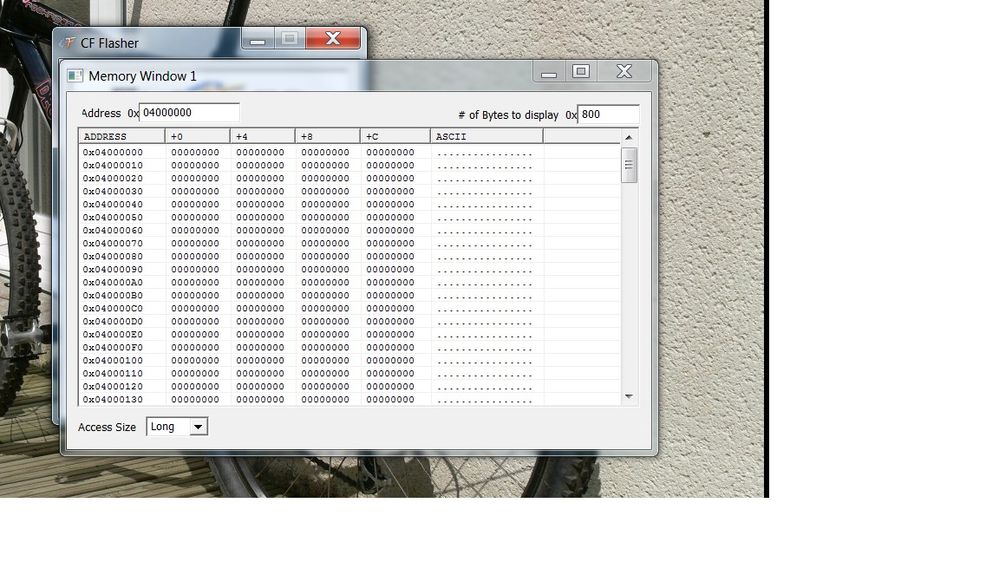

view memory:
view "logs"
before flashing:
flashing :
error flashing:
logs:
If you've ideas ...
I just bought this EVB (in 2017 ...) - When updating linux image, system crashed and erased the boot loader.
Thanks by advance.
Alain
