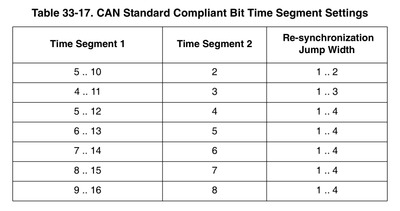

I can't see your code, so I have no idea what "can_id" is. There are no registers in the MCG54418 Reference Manual with that name. I'm guessing that's the second word in the message buffer.
How have you got CANMCR programmed?
That CANCTRL register has PRESDIV=12, PSEG1=1, PSEG2=0, PROPSEG=0. That's illegal. Nobody sets it up like that. That takes Fsys/2 and divides it by 13 and then has 5 Quanta in a bit, or one bit is the system clock divided by 65. Do you have a 32MHz clock perhaps?
If you read "33.3.21 Protocol Timing", and specifically "Figure 33-19. Segments within the Bit Time" it says the minimum value for the above sums is EIGHT and not FIVE as you have. If you're running 32MHz then you should have 8 or 16 quanta and have PRESDIV set to 7 or 3 as appropriate to divide by 8 or 4. That gets you an exact 500000 bits/second.
That might explain why the poor thing can't receive properly and can't transmit. It can't get around to all the work it has to do within a bit with too few clocks. It needs at least 8 clocks per bit to get everything done.
How are you getting those PSEG values? I thought the driver or the "ip" program was meant to select a valid set of numbers given the system clock and the requested baud rate.

Also, NXP datasheet says intervals should be
So seems i am a bit out as a bitrate and as time segments.

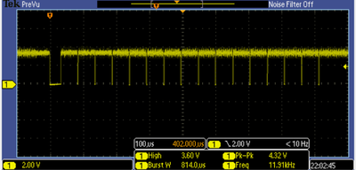

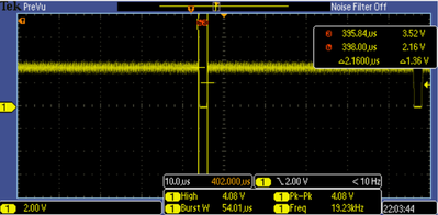

Setting can up on MCF i see
 and
So yes, looks like i am near 475 bps. Will try to adjust the
clock now, let's see.
