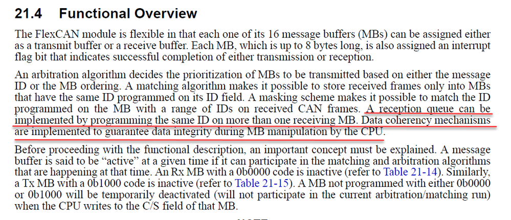

Hi all,
I have a question about flexCAN message buffer on MCF548x.
flexCAN has 16 MBs for Tx and Rx.
I set 14 MBs(MB#0 ~MB#13) for Rx and 2MBs for Tx.
And, I set same ID(i.e. 0x4AA) to MB#2 and MB#7.
But, when a master send a packet data, flexCAN receive the packet data via only MB#2.
I want to know how I can use MB#2 and MB#7 on the same ID.
3,656 Views
Hui_Ma
Below description at MCF5485 reference manual about FlexCAN reception queue description is incorrect.
This feature functionality is confirmed does not exist at ColdFire (MCF548x) FlexCAN module.
The contents at reference manual is incorrect.
Sorry for the document issue may bring any inconvenience to you.

TomE
Specialist II
Hui Ma already answered this question as it being a documentation error. That chapter in the manual has been partially edited to match the features in the next version of the FlexCAN module. Or, more likely the starting point was the chapter for the next version that then had the "new features" removed, but they missed that line.
That manual only has one match for "reception queue" in that one sentence in the Functional Overview. The MCF52277 and MCF5441X manuals have that sentence, plus FOUR other mentions in the chapter. One is in the "Feature List". Another is in the "Matching Process" section. It is also detailed in the "CANMCR[BCC]" bit, which the MCF5485 doesn't have. Also in "Initialisation". So those ones really have that feature and the manuals are correct for them.
