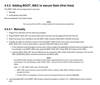

AN5401(file name)

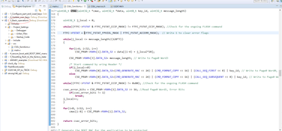

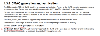

in csec module, i will must run third step as above when i caculate mac ?
because i see project of example-3, it is not run third step, as follows
