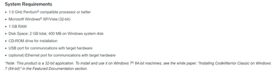

For the CodeWarrior for ColdFire (Classic IDE) V7.2 with below system requirements:
You could find [Licensing and Registration Support] info at bottom of this webpage. There listed how to install the USB Dongle info.
If there still with issue to install CodeWarrior license, customer could visit NXP support portal to submit a service request. Thanks.
