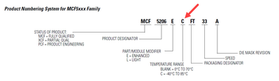

What is the difference between MCF5307AI90B and MCF5307CAI90B chips?
I was not able to find the ordering info in the datasheet, and the meaning of this additional "C" in the middle on p/n is unknown.

Please refer below picture about ColdFire product partnumber naming rule:
