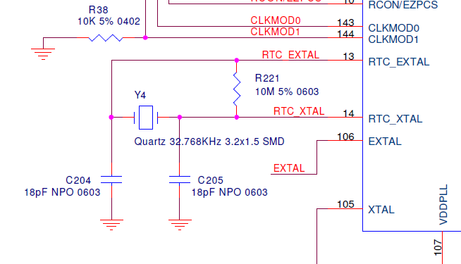

We have a problem with the RTC on MCF52259.
We put a crystal 32.768Hz between the RTC-EXTAL and RTC-XTAL pins. A battery backup (3V button lithium) to the VSTBY pin.
The RTC works only in battery backup mode. In this case it is possible to see a 32K768 oscillation on pin RTC-XTAL. When we put the the micro in normal operation (power supply from 3.3V), the oscillation on RTC-XTAL is stopped and the RTC stop to work.

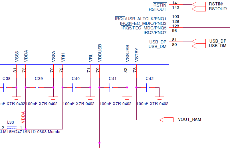

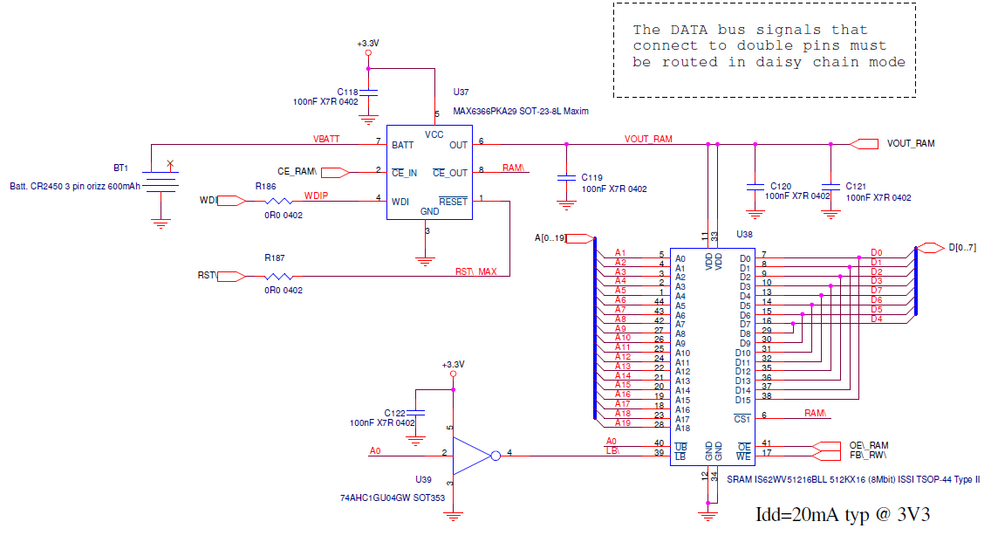

For completeness I enclosed the battery backup section:
the connection to microcontroller:
and the RTC section:
As you can see, the power 3V3 and the Vbatt (3V from lithium battery) are managed through a supervisor MAX6366 for the Vstby. The RTC power supply sections are always active. In fact, when the power 3V3 is off, there is an oscillation and so there is an increment of count...
I hope I have given useful information, waiting for news, I wish you a good day.

after some attempt I have succeeded to start the RTC.
I have done some passages, but I have repeated the entire procedure for 6 devices and all of them work now.
As I mentioned before I have mounted the MAX6366 to manage the battery. So first of all I have tested this device:
    -I have mounted the battery;
    -I have connected the power supply;
    -I have disconnected the power supply.
At this point the MAX6366 is ok, in fact without the power supply there is the oscillation on pin RTC_EXTAL.
So I have loaded the software in this mode:
    -I have disconnected the battery
    -I have loaded the software with the procedure of initialization of RTC:
        RTCCR = 0x57;
        RTCGOCU = 0x0;
        RTCGOCL = 0x00001FFF;
        At this point the RTC should count. Note that at this point the value of the register RTCCTL was 0x80 (RTC enabled);
    -without disconnect the power I have connected the battery;
    -I have switched off the device.
Now, when I power on the device, the RCT works. If I power on the device without the battery the RTC works again correctly but, rightly, starts from zero.
Thank you for your support,
Diego.
