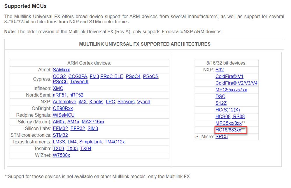

I am looking for a progeamming tool for MC68376BGCFT20 or SC68376BGCAB20.  I am assuming it reqires hex or some sort of firmware file. This is a legacy product and we dont have much data on this design.  We have firmware file which I think for the micro but NXP has no info on programmer required for this chip.
There is also a bootloader firmware in a flash chip circuit of our board which uses MX29F200CBMI-70G.  We loaded the bootloader firmware but that didn't get board to run.
Any help will be greatly appreciated.

Hui_Ma
hi
Please check below tools from P&E company:
1> Multilink FX
This tool shows supported MC683xx product program.
2> PKG 683xx Development Package
Please contact P&E support for any sales issue.
Wish it helps.
