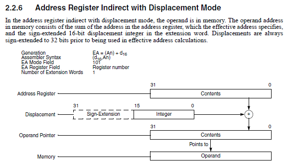

flvloveu
Hi Tom,
     Thanks for the answer. Actually, I don't know how they work and what they are  good for in my question.
     As your suggestion , I find a document named "ColdFire Family Programmer’s Reference Manual" at the head of Chapter 3.Now , I see it is Address Register Indirect with Displacement Mode. I try to execute "move (2,a0),d0", but ,a error occur. Anything I was wrong?

TomE
Specialist II
Now you know how the CPU instructions work.
What you now have is a very different problem.
The assembly syntax shown in the Programmer's Manual is only one way of representing that instruction to an assembler.
The people who write assemblers don't seem to take much notice of the manuals. They seem to "know better" and have their own favourite ways of representing parts of the assembly instruction.
So it may be "move" or "movel" or "move.l" or "move_l" and "2" or "$2" or "#2", and "a0" or "%a0".
I'm using gcc and it seems to prefer things like "movew %a0@(4),%d2".
So you now have to read the manual for the Assembly Manual that you're using to see how they expect assembly code to be written.

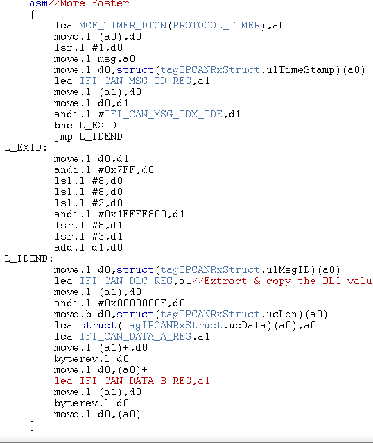

flvloveu
Hi Tom,
     Thanks for the examples and the kindly answer.
     You are right.As your suspect, I had used "asm {}" in a C file and I use the CodeWarrior 7.2 .So, it seems the Compiler is not spported to this instruction.
     >>Why are you trying to use assembly code in "fpgaCAN.c" which looks like a CAN driver?
     Yes, it is in a CAN  interrupt . More important thing is that I am learning assembly language of Freescale, so that , I can handle some bad conditions that the code  can run more faster.
      In conclusion,  I know more about  assembly and instructions and I can use some basic instructions to finish some code instead with C.
A new question , if I want to rewrite codes "CANRXMSG *pCurrentMsgBuf = &(CANstruct.RxBuffer[CANstruct.usRxBufHead]);" CANstruct is a global variable , how can I do?
Now I write them as :
   I think I use a bad method to get the pointer.
     Thanks again.

TomE
Specialist II
You've got an 80MHz CPU. The fastest CAN port is 1MHz and takes between 50 and 110 bits to deliver a message. So the maximum message arrival rate is one every 2,800 CPU instructions.
So why do you need to try and make it a bit faster when the CPU has that much speed?
You can probably save a lot of time somewhere else in your code if you need it.
Writing maintainable code is far more important that writing something "just a bit quicker". If I was your boss I wouldn't let you write assembly code in that function.
If you must have assembly you should write it as a separate standalone assembly code file, not using the "asm" construct.
Your code is a little inefficient. You should be using more registers and you shouldn't be using address registers for data operation as they're more restricted in what they can do. The first thing your code should do is a "moveml" to free up registers for efficient use.
I can't see that the compiler would do that bad a job, UNLESS you've got it configured in "debug mode" which generates unoptimised code so it is easy to single-step. You should let it generate "release" code with a high level of optimisation and compare that with your assembly.
It may be that CW isn't that good, even if you configure it properly.
Can you provide a stand-alone (main() plus function calls) program with the internals of the interrupt handler written in C. I'll compile it with gcc and we'll then see if it can do any better?
I've just done that for the part of the code that moves and merges the extended ID and the code from gcc ends up like this:

So that's 9 instructions, doing the same as your code does in 10. The "moveq #15" in there is just setting up for masking the DLC.
It would be better to move that operation out of the interrupt routine and perform that operation in the mainline code though. The interrupt routine should do the bare minimum.
What you do need is to declare a static inline assembly function that can contains the "byterev.l" instruction (ONLY) to do the byte swap for you. That SHOULD already be a part of a provided library for the ColdFire chips. I'd look to see if one has already been provided in CW before writing one yourself.
