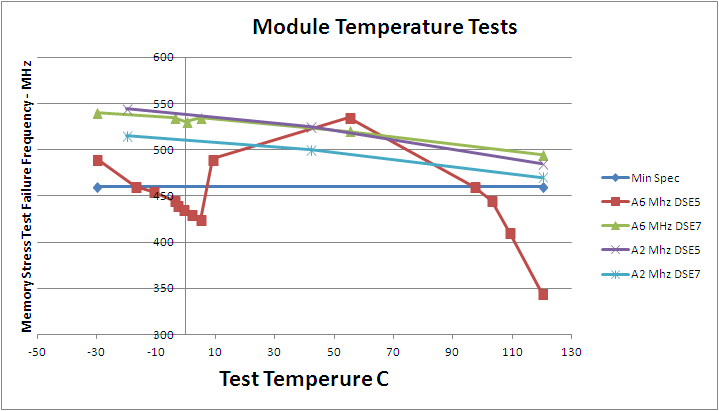

We had a similar problem with the i.MX53 chip. Some boards wouldn't work at temperature extremes. Other ones would:
The above graphs the maximum memory bus frequency that the Freescale Memory Stress Test would run at versus temperature for two different boards. The rated DDR3 frequency for the i.MX53 is 400MHz.
The Red "A6 MHz DSE5" line is for a board with a partial hex serial number of "A6", showing temperature sensitivity. The purple "A2 Mhz DSE5" is the same test on a different board.
After testing a lot of boards we found the temperature sensitivity seemed to varying in a CYCLIC MANNER directly and linearly based on the board serial number.
Huh?
The boards are made on large PCB panels, and are serialised (something like) left to right, top to bottom. The panels are "impedance controlled", which means they have an impedance test area in one or two places. But the actual impedance and (more importantly) the thickness of the inner layers of the board probably varies across the board. If we knew what the variation was and knew how to measure it we could probably draw a "contour map" on the panels that corresponded to the above measured sensitivity.
You'll notice that boards "A2" and "A6" both work fine at "DSE7". That's the DRIVE STRENGTH setting of the DDR Address and Control Lines.
The Reference Manual documents that DSE5 and DSE6 are identical. It is wrong. We ended up changing the Drive Strength for these signals to "6" and it fixed the problems.
