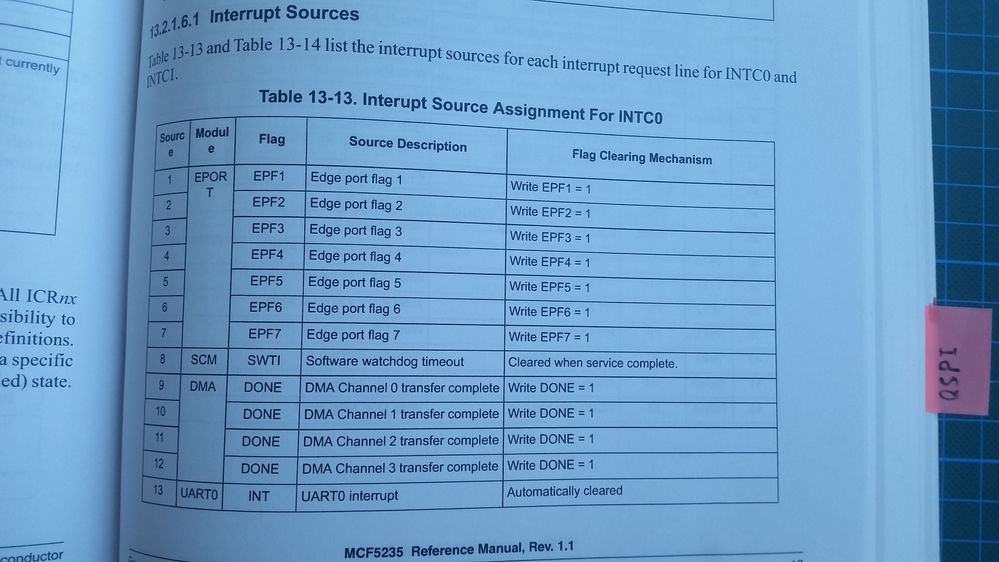

richardwielend
For sure I meant: " I have not found the "Syntax highlighter" button... previously" :smileygrin:
So I found it with your help, thanks :smileyhappy:
>They MUST be different for every separate interrupt source, and that includes every EPORT. All seven of them have to unique Priority:Level. So if you want all EPORTs at the the same level, then they have to have priorities 1, 2, 3, 4, 5, 6, 7.
Yeah I wrote the settings are:
USB_Read: m_byInterruptLevel:1 m_byInterruptPriority:1
Button_OFF: m_byInterruptLevel:2 m_byInterruptPriority:2
Button_OPEN: m_byInterruptLevel:3 m_byInterruptPriority:3
TRIGGER: m_byInterruptLevel:5 m_byInterruptPriority:5
EPFn is written a level above, so you can´t see it in that routines.
So .. I´m pretty sure it´s a fluke, as you can see in the attached picture.
And the last thing you suggested, I have to admit that I haven´t got what you wanted to explain :smileysad: Could you reexplain it another way ? :smileyhappy:
best, Richard
There's no "attached picture". Could you try again, or say what's in the picture as text?
The last thing I suggested was that you delete the duplicate post. So I assume you mean the second-last thing. But it would help if you'd have said which thing.
So I have to guess you are referring to my numbered-list 1-7. Do you mean all of that or just the last item it that?
I'm suggesting you read the EPORT control registers and print their numeric values either side of when it works and when it doesn't.
I wouldn't recommend different levels AND priorities. You should normally have all "similar interrupts" that are being handled similarly at the same level, distinguished by priority. That way they can't accidentally interrupt each other.
