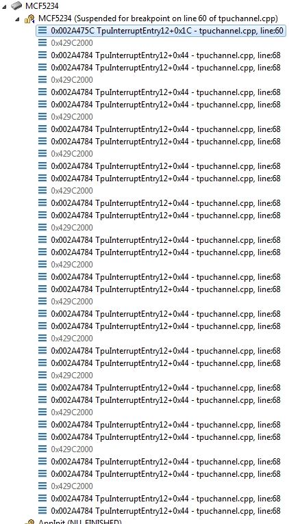

4) I did not write, but we don't simply enable/diable the interrupts in the ISR. As you stated, the IPL is set to 7 and restored to the previous IPL when the critical part is finished.
Each interrupt has its own and unique ISR with unique priority/level.
(We had that priority/level problem before and fixed it in the past.)
I attached a screenshot below. Have a look at the Exception Stack Frame 0x429C2000. It's vector 167 (TPU 12) but with SR 2000, doesn't that mean IPL = 0? TPU12 runs at level 5, prio 3. The interrupt level mask is set to the active interrupt level during the ISR, isn't it? So it should be 5.

I suggest you read "11.1.2 Exception Stack Frame Definition" in the "CFPRM.pdf" (ColdFire Family Programmer’s Reference Manual).
Using that to see if "0x429C2000" is what I think it is (the exception frame), it decodes as:
Aligned (4)
FS=00 00 - Ordinary Interrupt
VEC= 29C (Vector 167)
*PREVIOUS* SR is 0x2000
That's the previous SR the was active when the interrupt happened, It is pushed onto the stack (so it can be restored later). If you want to see what the CURRENT interrupt level is, check the CPU registers during that debug breakpoint.
To see how it all works, read CFPRM "Chapter 11, Exception Processing, 11.1 Overview".
If you still seem to be getting a "double interrupt", hitting that "if" condition, then check the stack frame when you hit that breakpoint. The stack should show two sets of interrupt. Note that it is possible that the debugger won't be able to decode the stack frame properly, so you may have to take a raw memory dump of the stack and decode it yourself.

sirlenzelot
Thanks, Tom, for your answer.
The exeption stack frame contains the previous level. I read that over.
I had a look at the stack and figured out that I have two different conditions in which the "double interrupt" occur.
a) I can see only one ex. stack frame on the stack.
b) I can see a second ex. stack frame on the stack: 0x41902500. Which means interrupt 100 (PIT0, the timer of our OS, runs every 10ms) and priority level 5, which is the level of the TPU12 interrupt I have problems with.
