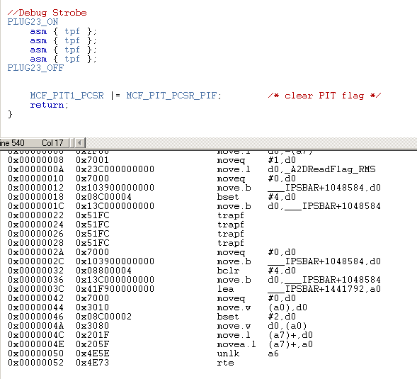

For the MCF52235 at 60 MHz instructions seem to be executing much slower than expected.
I don't have much experience with the ColdFire V2 core and could use some help.

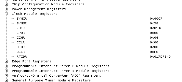

My configuration is an external 25 MHz crystal and then the PLL configured for a 60 MHz system frequency.
The CCHR register is 0x04, so divide external crystal oscillator by 5.
The MFD bits are 100, and RFD bits are 000.
So the system clock should be 25MHz / 5 * 12/1 = 60 MHz.
And indeed the configuration seems correct because the measured CLKOUT signal (pin 1) is 16.6 nsec.
But the instruction execution time looks too slow when a output pin is toggled with know instructions in between.
For example:  (See the attached C and assembly code)
1) Set output pin high,
2) Execute five trap (trapf) assembly instruction,  (1 cycle instruction used instead of NOPs)
3) Set output pin low.
The measured time for the pin to toggle is ~9 uSec.
Based on a 16.6 nSec clock and the number of cycle used between toggling the pin, I would expect the execution time to be well below 200 nsec.
I've tested the timing using the trap, and also with NOPs.    Both gave basically the same execution time.
I don't think the processor is getting interrupted between setting the output pin high and then low.   The last test I did was to put the test in the pit1ISR and the timing was the same.
Please see the attached code and my clock settings.
Do you agree 9 usec in much too long?
Any ideas what might be causing the problem or how to narrow it down?

Hi Tom,
Thanks for all the information.  This is a part time gig, so I haven't had time yet to look through all the information and links you provided.   I did realize there was latency when using the GPIO for timing strobes, but felt the execution delays I was seeing were too long even with the latency considered.
Per your suggestion I measured the instruction execution delay on a bigger scale:
I have code that sets external muxes and reads the A2D 26 times, and in between does calculations with each result.    This code executes in 602 usec repeatably as measured with a bit output strobe before and after execution.   I made the following changes to the code:
I added 1 trap ( 1 cycle ) instruction after each of the 26 A2D reads.   The execution time went from 602 to 633 usec.
I added 2 trap instructions after each of the 26 A2D reads.  The execution time went from 633 to 664 usec.
I added 3 trap instructions after each of the 26 A2D reads.  The execution time went from 664 to 695 usec.
So for each addition of 26 trap cycles the execution time increased 31 usec.  Each trap instruction is adding approximately 31/26 usec = 1.19 usec.
To answer your question.    This project is based on the ColdFire Warrior TCPIP Lite Rev 3.2 project.   I don't know if it is running out of FLASH or RAM, but will investigate.
Based on the measurements above, instructions are executing 1190nsec / 16.6 nsec = 72 times slower than expected.
Clearly I am missing something.
Your thoughts are welcome.
Thanks again.
