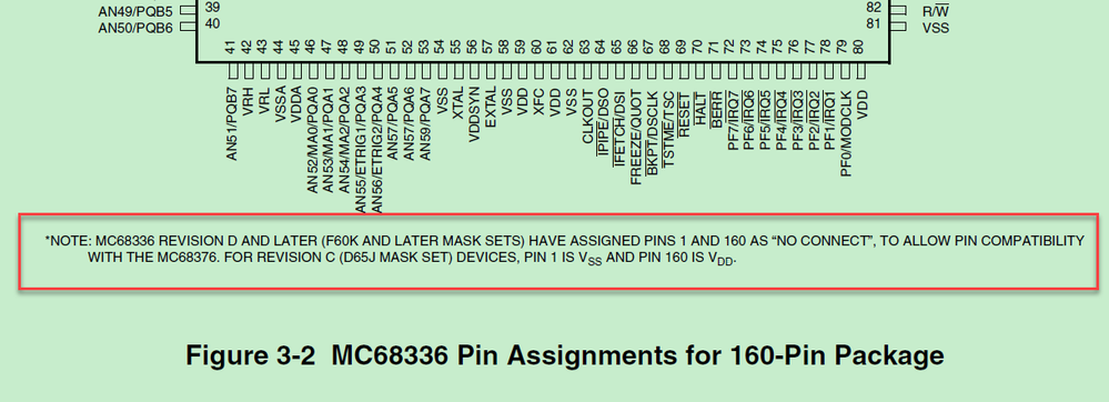

Since MC68376 and Mc68336 has the same internal CPU32 Core, the instruction set between this two are the same, means the fetch and execute codes are basically the same if the program it is the same.
Also check this note *NOTE: MC68336 REVISION D AND LATER (F60K AND LATER MASK SETS) HAVE ASSIGNED PINS 1 AND 160 AS “NO CONNECT”, TO ALLOW PIN COMPATIBILITY WITH THE MC68376. FOR REVISION C (D65J MASK SET) DEVICES, PIN 1 IS VSS AND PIN 160 IS VDD.
So, customer can left MC68376 pin1-CANTX0 and pin160-CANRX0 floating.

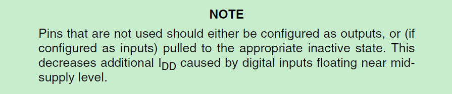

From the MC68376 user manual, the CANRX0 pin is input and CANTX0 pin is output during reset and after reset.
There with below Note to avoid input direction pin floating, which could add system power consumption:
Based on this note, we would recommend to pull up/down CANRX0 pin with 10Kohm resistor & CANTX0 pin is output direction can left floating.
Yes, you can tie two pins (pin 1 and pin160) together with a 10Kohm resistor to VSS/VDD (with disabled TouCAN module).

Tie the two pins (pin1 and pin160) together doesn't affect MC68376 functions, which looks like TouCAN module works in loop back mode.
While, that design will bring big potential risk.
I just imagine a scenario that if the board replace MC68376 chip with previous MC68336 chip one day, especially FOR REVISION C (D65J MASK SET). It connects the chip VSS and VDD together.
So, if possible, I would not recommend to tie two pins (pin1 and pin160) together, handle two pins separately with external pull down/up resistors. Thanks.
