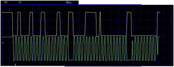

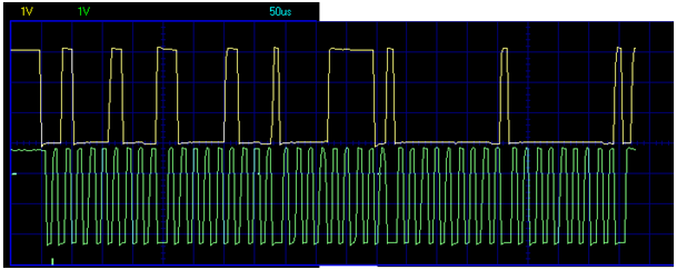

My objective is to imitate an IIC and an UART frame, and on both, i have problems :
-On my IIC frame, i succeed to imitate the initial frame with the SDA (data), but, the SCL (clock) is not exactly the same :
my generated frame :
and the frame i want :
I apologize for the poor quality of my records. Green : SCL, Yellow : SDA.

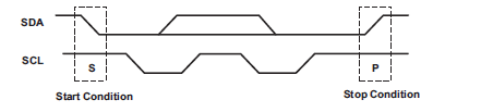

The objective of the IIC is a transmission only : the Coldfire MCF51CN128 transmit this data to a TCA6424A without any return. as you can see, there is a problem between frames : the "end of trame" is not here on my generation, and more important, my end of transmission isn't good. It has to be like this :
and, on my generated frame,the stop condition is wrong.

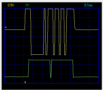

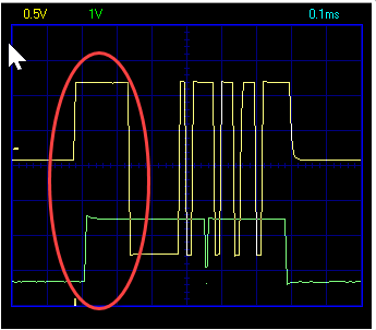

-On my UART frame i succeed to generate a frame with exactly the good data that i need, but, what i try to imitate isn't a single frame, it's 2 frames who take turns. The problem is : My communication start is too long : it is 3 bits longs to high level before the communication starts, given that there is 2 frames , i have 3 bits instead of 1 on the middle of my communication. This UART communicates with a kinetis MKL03Z16.

Hui Ma has given a confusing response as he has used the words 'GPIO emulation code". I have no idea how you can emulate GPIO, or maybe he meant using timed code and the GPIOs to emulate a UART. We now know that's not what you're doing.
However, you're not using the UART to just transmit and receive data as the oscilloscope trace is showing three levels. So you must be using a serial protocol that has multiple devices sharing a single wire, like LIN. But according to your oscilloscope trace, using +-3V or so.
So you must be using a GPIO pin to enable the transceiver (and a different one to turn the LED on) and then write to the UART to send data.
You're getting a variable time between those two writes to the GPIO and when the UART start transmitting. That can only mean one of two things. Either your code is taking a variable time between those two operations, or the UART is taking a variable time to start. How are you enabling the transmitter, and when in your oscilloscope sequence? Are you programming it to "send idles"? It might be sending "frames of idles" and can only start sending the character you want to transmit when the previous send or idle has finished.
As for the I2C problems, it looks like you're not generating the STOP condition. Look at the flow charts. You have to set MST=0 to generate a stop condition.

Thanks for your answers, And yes, i am using a double wire RS485,And again yes, i am using a GPIO pin to enable a MAX3072E , and then, i use the UART to transmit data.
I am enabling the MAX3072E in initialisation, and then my UART code looks like this :
EnTx = 1 ; // enable of MAX3072E in initialisation
SCI1C2_TE = 1 ; // enable Transmit UART
while( (SCI1S1 & SCI1S1_TDRE_MASK )== 0 ){}
SCI1D = firsframe ;
while ((SCI1S1_TC & SCI1S1_TDRE) != 1 );
SCI1C2_TE = 0 ; // end of transmit
For my IIC, i got wrong cause of my oscilloscope, my stop condition is well generated at the end i correctly used MST=0 in my IIC program.

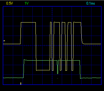

I just add some things concerning the UART module :
The problem is kinda strange , the program just loop on himself, and, half of the time, the frame send is not the same :
or
in yellow the Data send on UART,
in green (state of a led ), the status of transmission : high : transmission active , low : transmission finished.
as you can see, the first frame to transmit is sometimes way too long, but, the second one is always short.
the data send is  0x40 for the first frame, and 0xDB for the second frame.
Also the begginning of both transmissions is too long : i should have just one start bit for each frame. Those frame does
not work.
Any ideas of how to reduce the lenght of the beginning ? or what is the reason of this behavior?
Thanks a lot for your help !

Hui_Ma
I suspected the GPIO emulation code was halted/interrupted by another higher level application or interrupt service routine at the first frame to transmit.
It need to disable all interrupt resource to make sure GPIO emulation code with highest priority to occupied the code(run the code).
Mike
