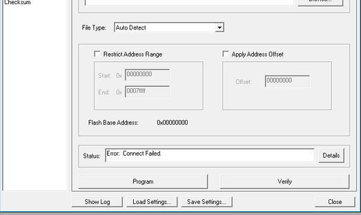

I installed CodeWarrior for ColdFire V7.1.
I am experiencing an error that says 'error: connect failed' after loading MCF52259_INTFLASH.xml and clicking program. I am using the P&E ColdFire Multilink JTAG.
Please let me know how this can be resolved.

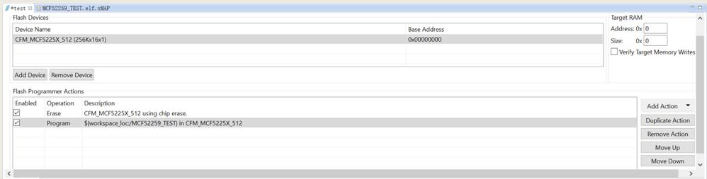

The P&E USB-ML-CFE (USB ColdFire Multilink) has been discontinued. The recommended replacement part is the all-in-one Multilink Universal. Most software products will support the Multilink Universal transparently. I think there missing USB ColdFire Multilink driver for your PC so far. Please check here for the detailed info from P&E USB ColdFire Multilink webpage.
If possible, customer can use the CodeWarrior for MCUs IDE V11.1, which also supports MCF5225x product. The embedded [Flash Programmer] tool supports MCF5225x Flash, please check below picture for the detailed info:

@Hui_Ma When attempting to update with CodeWarrior i am prompted with Error: connect failed. Does this possibly mean a driver is missing?
5,461 Views

BufferGHz
@Hui_Ma I do have [USB Multilink 2.0] listed, thank you very much for the guidance and support. It is still saying Error: connect failed. It is possible that a setting is incorrect in the setup. Please see picture. I was thinking that the directory where Freescale is downloaded is incorrect.

Hui_Ma
First of all, Please check if P&E USB Mulitilink tool both LED are lighted (traget board was powered already). I couldn't find there with any setting issue with above attached picture.
CodeWarrior for ColdFire V7.1 is quite old, which supported PC OS is Microsoft Windows® XP/Vista (32-bit).
I would recommend  customer to install latest CodeWarrior for MCU V11.1 and create a quite simple project for MCF52259. Then customer can use embedded [Flash programmer] tool to program file to MCF52259. Please check below picture for the detailed info:
