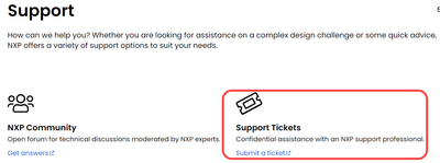

About CodeWarrior software license issue, I would recommend to use NXP online service (submit a ticket). My software license relevant teammate is willing to support that ticket.

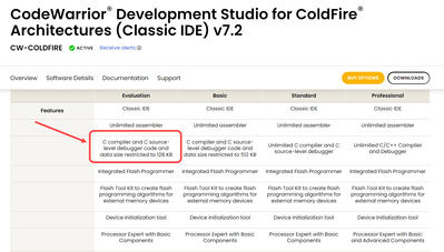

Please refer below picture about each version CodeWarrior for ColdFire software difference:
The Evaluation version CodeWarrior software has limited C code and data size, total should below 128KB.
