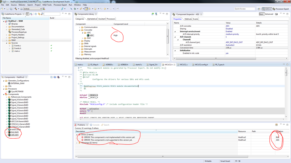

Hello everyone!
I'm having problems with the MCF5441X family of microcontrollers with some Processor expert libraries.
The high level components (BITIO, TIMERs, etc...) get an error called: "This component is not implemented in this version yet!" and I can't start programming with the Professor expert tool.
Can you help me? I attach a picture

Good morning, sir.
I explain: Any high level component of the processor expert is not compatible with the MCF54418. I need to use these libraries to control 2 external components: an AD9826 to convert video images and a sensor that works with clock signals. I am enclosing what I have on my project but I would like you to offer help as soon as possible.
Another issue is that I need libraries to control a NAND RAM memory and another DDR2 (MT29F2G08ABA and
MT47H128M8CF-3 IT respectively).

Hui_Ma
I am checking this issue with CodeWarior software team.
I will update when there with any feedback.
Thanks for the patience.
