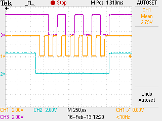

sinanmuratkeşen
Hi Tom,
Thank you for reply. I have already monitored SPI signal with oscilloscope and the signals was right. TEK0000.BMP
The purple one is data.
The yellow one is clock pulse.
The blue one is chip select.
Also I had monitored SPI signals via RS-485 port of slave device and I realised the signals was right.
Sinan.

TomE
Specialist II
You have captured one data signal. To see what is happening you need to monitor the input and output data pins. Then send the command sequence that should be trying to program a FLASH location and compare that with the data sheet for that FLASH device. Then perform the read operation and compare with the data sheet.
Remember that with SPI that you send a command in one cycle and read the results of that command back in the NEXT cycle. All the reads happen one cycle later than you'd expect with a parallel bus.
Tom

TomE
Specialist II
Examine the SPI signals with an oscilloscope and decode them. That's always the easiest way to find what's going wrong.
Tom
