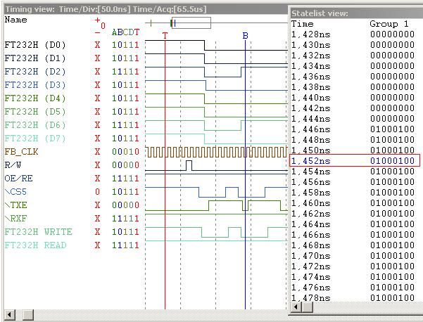

We're developing with a NetBurner MOD54417, using the CS5 chip select and the FlexBus in 8 bit (no burst) mode. The peripheral
will be FTDI's FT232H USB chip in asynchronous FIFO mode. I'm new to the ColdFire, but I think I have it set properly for the bus
mode we want. However, CS5 is asserting twice during a byte write - once in the address setup cycle and once for the data. The
FlexBus specs show it as a single assertion. I'm thinking I must be missing something outside of the usual csar, csmr, and cscr
register setup. I realize I'll have to manipulate the timing a bit with a latch or counter to get the FT232H timing right, but I don't want
to deal with a doubled up chip select assertion as part of that.
NetBurner doesn't meddle with the CS5 signal from the ColdFire, they only have an address latch on board to de-multiplex the bus.
Register values for CS5:
csar = 0x04000000
cscr = 0x1140; //no CS5 delay, 4 waits (38 ns. CS assertion width)
csmr = 0x00000001
Attached is the logic analyzer trace. Cursor D is just to the right of the data becoming valid.
Any feedback on this issue will be greatly appreciated!
Ray

Thanks for providing the logic trace. It looks pretty clear what is happening.
Your trace doesn't show FB_ALE so you don't actually know when the address part of the cycle is.
What I can see is CS being asserted for about 5 clocks. Since you have Internal Termination programmed, FB_CSn should be asserted for ONE clock plus the number of wait states. In your case that is set to 4 so EACH of those 5-clock FB_CS5 assertions is one whole and separate bus cycle.
So I can see two separate write cycles to two different addresses.
If you think your code is meant to be performing only a single write, then maybe the code is performing a WORD (16-bit) write which the FlexBus controller will convert to two successive writes. That probably isn't what is happening as the addresses aren't sequential.
If you look at the Data Bus you can see the first cycle has 0x00 on the data bus and the second has 0x41.
Which pins on the CPU do you have "FT232H (D0-7)" connected to?
I'm guessing you may have them connected to FB_AD[7:0] given the signals I see on them.
If I'm right, since it is a multiplexed address and data bus, the first cycle is a write (as R/W is low) to the address 0x??????00 and the second one is to 0x??????41.
The value on those pins doesn't change between the address and the data parts of the cycle as the CPU doesn't change FB_AD[23] during byte cycles. Look at "Figure 20-14. Single Word-Write Transfer" in the Reference Manual.
The Data for a byte write is written and read on FB_AD[31:24].
If you do have the wiring correct, and have the FT232 connected to the UPPER 8 bits of the Flexbus, then your code is writing 0x00 to 0x00?????? followed by a write of 0x41 to 0x41000000.
Since CSAR is set to 0x04000000 that is impossible. You can only see addresses from 0x0400000000 to 0x04FFFFFFFF on the bus.
So I think you're using the wrong end of the Flexbus.
Welcome to the world of BIG_ENDIAN CPUs. The MSB one at the left is "Byte 0" and the LSB one on the right is "Byte 3".
If you do have made the boards with the FT232H connected to FB_AD[7:0] and need to leave it like that, or just want to test it, change the port to be 32-bit and then address the chip with sequential 32-bit addresses with the data in the lowest 8 bits.
Tom

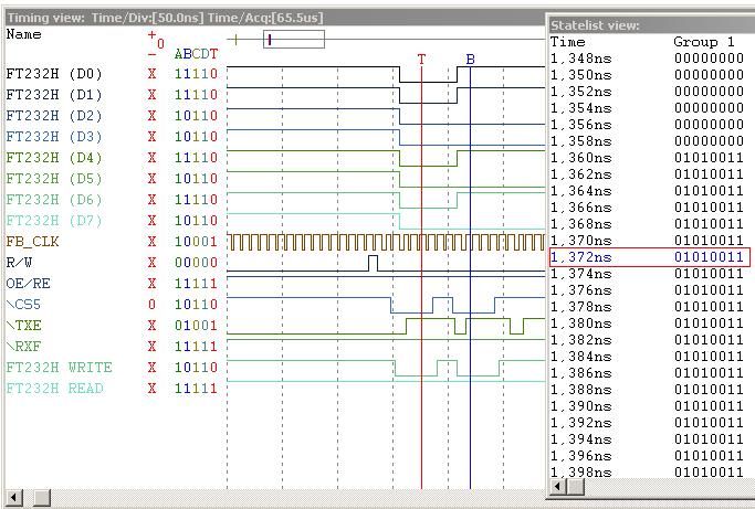

Thank you for taking a look at this, Tom. The FT232H is in fact attached to the high byte of the bus. I label them D0 - D7 for convenience from a peripheral viewpoint. The NetBurner MOD54415 and MOD54417 modules only bring out the 2 high bytes to developers. Also, they don't bring out the ALE signal, but they do latch the address on their module. The logic traces show "D0 - D7" as all "0" during the first CS5 assertion; this would be the low byte of the address from the on-module latch. I didn't probe the high byte (AD8 - AD15) with the logic analyzer as there are enough probes hanging off the test rig as is.
The 2nd CS5 assertion is in fact my data. In this case (and the trace I posted earlier), just the letter "D" (ASCII 01000100) being sent. I've included the state list view for cursor B, at 1,452 ns. showing the "D" in Group 1:
If I change my code to output the letter "S" instead, I get the following trace, with an "S" (ASCII 01010011) at 1,372 ns. in the state list (cursor B):
I can do this all day long with anything that fits in a char. Here's my code - I'm using the NetBurner libraries:

TomE
Specialist II
I made a lot of wrong assumptions in my code, but I did get one thing right. I typed:
Your code is:
> *(unsigned short *)(PC_SIDE_B_IO) = (unsigned char)'?'; //Write char to PC
Change that to "*(unsigned char *)(PC_SIDE_B_IO) = ..." and it will work as expected.

rayvanvynckt
Thank you so much, Tom! That got it working. I had a brain fade about that unsigned short typecast - thinking it had to do with the 16 bit bus NB makes available to the outside world. And I did get the sample code from one of their older IO expansion examples. My understanding is the >> 16 shift in the example is due to that example being for an older ColdFire chip. Maybe they did something different in a header file for that particular chip.
Ray
