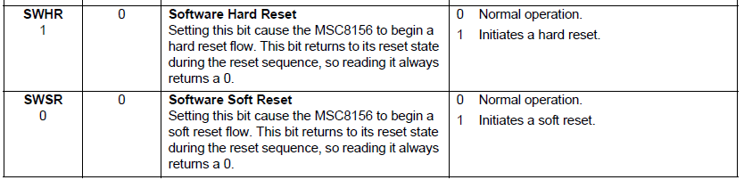

nguyentienluc
Now, I want to reset SC3850 DSP by writting code C in CodeWarrior instead of pressing reset button in board.How to do it?Thanks in advance!
7,834 Views
lunminliang
Hello Nguyen tien luc,
If you would like to "reset SC3850 DSP by writting code C", you could use Software hard reset or Software soft reset:
Software hard reset------A hard reset sequence can be initialized by writing to a memory mapped register (RCR)
Software soft reset------A soft reset sequence can be initialized by writing to a memory mapped register (RCR)
Also there is "reset" setting in CodeWarrior launch configuration, in the connection configuration. For your information.
Lunmin
